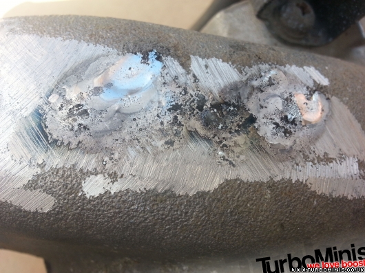

dialing in the power

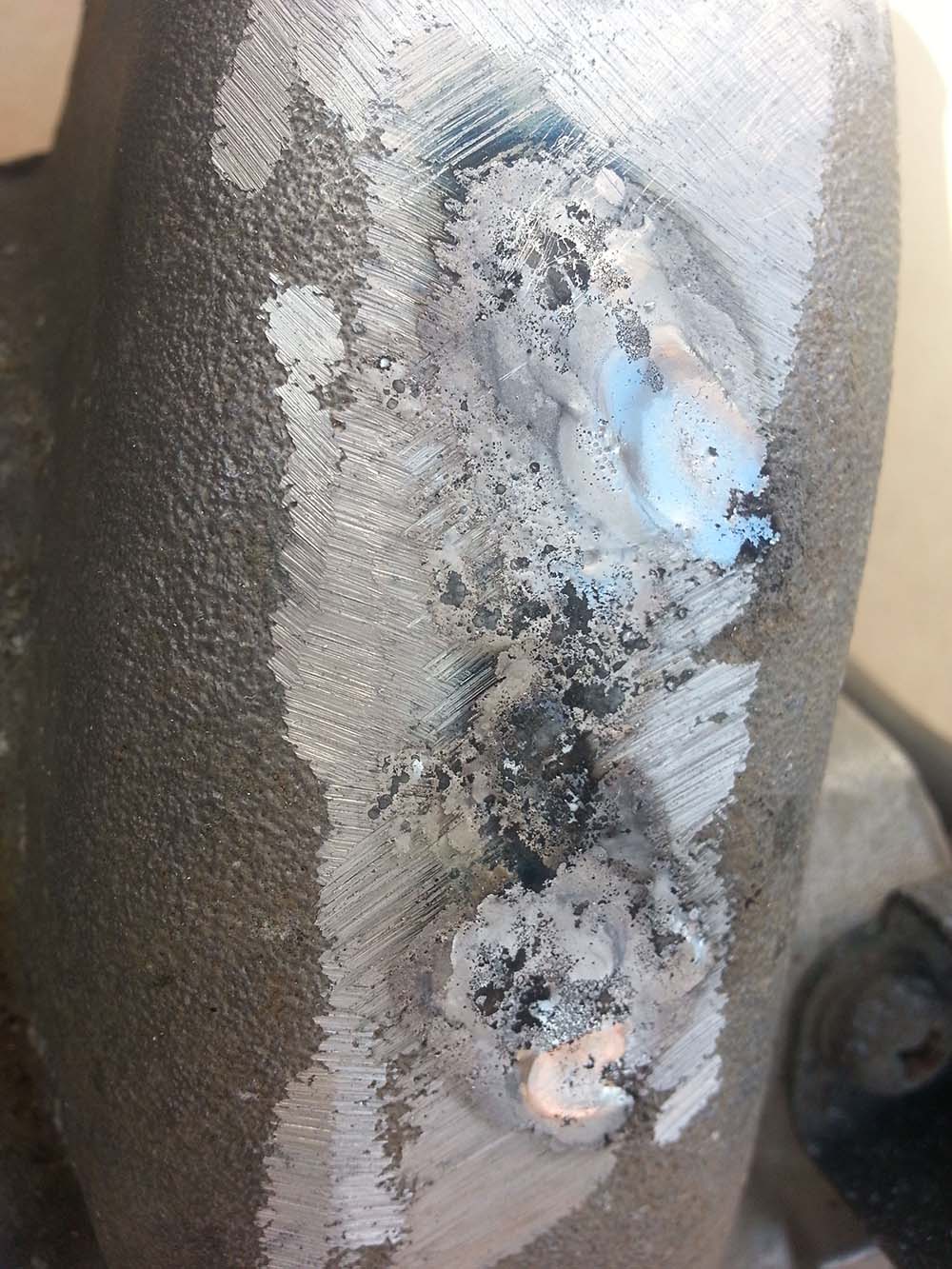

first test bead
then into the deep end *happy*

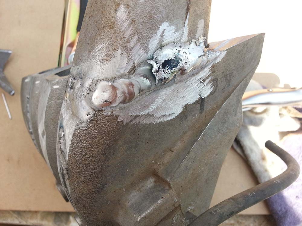

i know its not particularly clean or the best stuff to learn on but the first thing im going to weld is exactly this material so i figured its best to learn on it

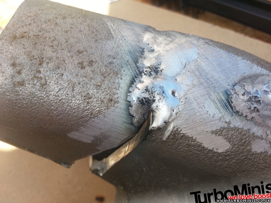

got a couple questions
the black speckles on top is that shit from the dirty ally or not enough gas
can anyone tell if its enough power or maybe a little too much
my regulator is for both co2 and argon but only give a psi out reading, would i be better off getting some sort of cfm meter too
other than that im reasonably impressed with it, any input welcome
cheers
Edited by Brett on 21st May, 2014.
Not clean enough, no where near. Abrasives embed into alloy giving the black shit when you weld. Use scotchbrite pads to clean back before you weld.
cool cheers,

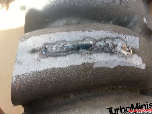

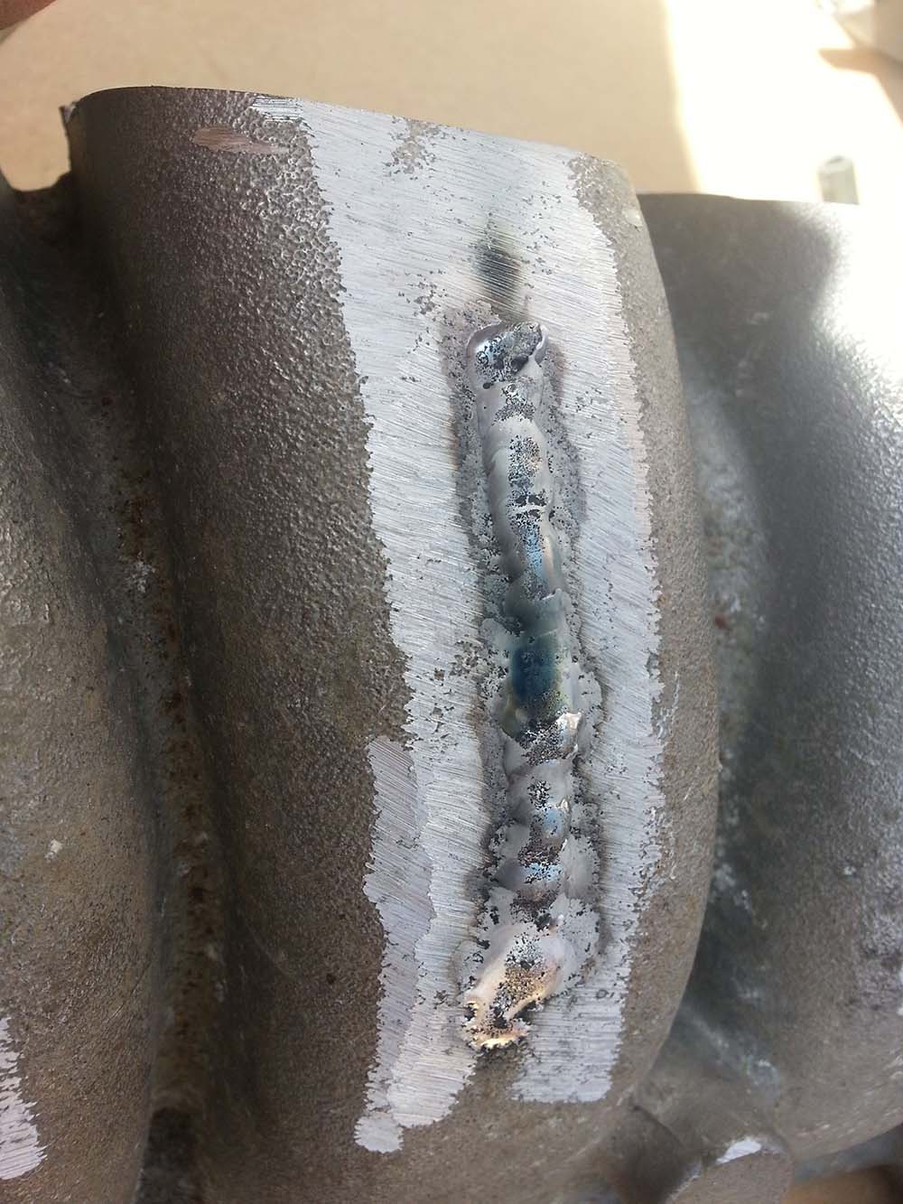

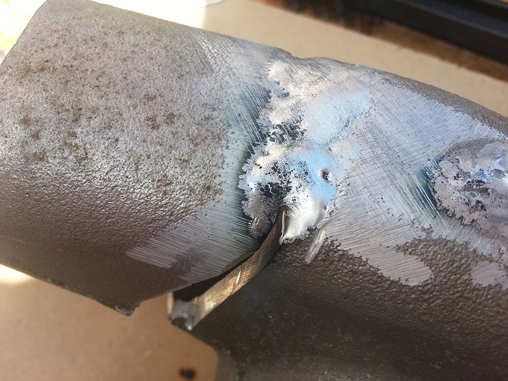

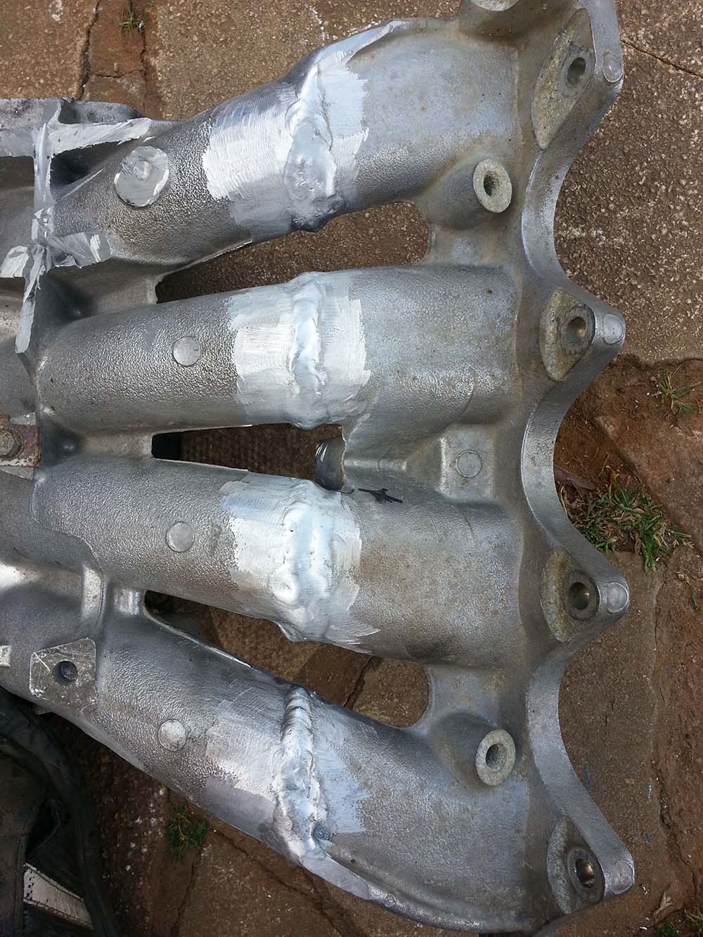

tapped the gap closed and went down the side, a little bit of bridging in there, and i dont think it turned out too bad
i will scrub up the next bit best i can :)
Scotchbrite Rolocs on a 90deg die grinder are what you want.
practicing with what i have at hand to clean up i find a fine cutting disc rather than a grinding disc to take back the cast and general crap, then a stainless wire brush and it welded without most of the black speckles
so cracking on...

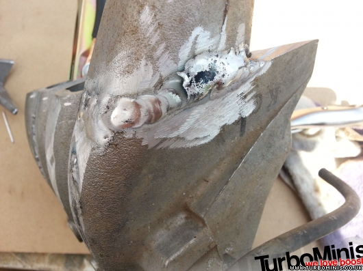

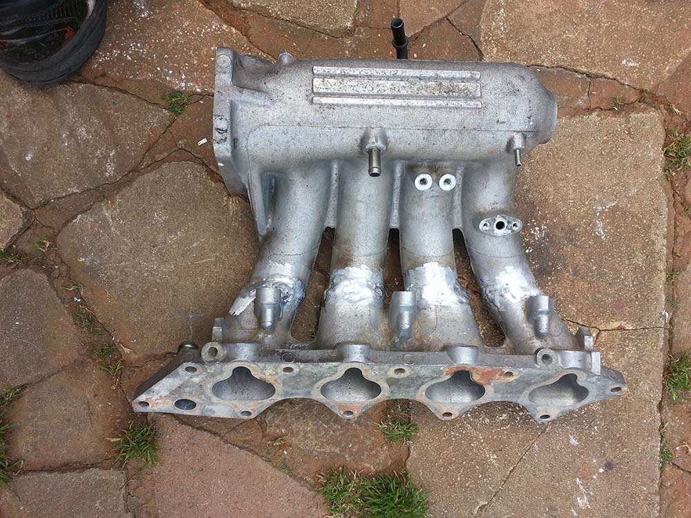

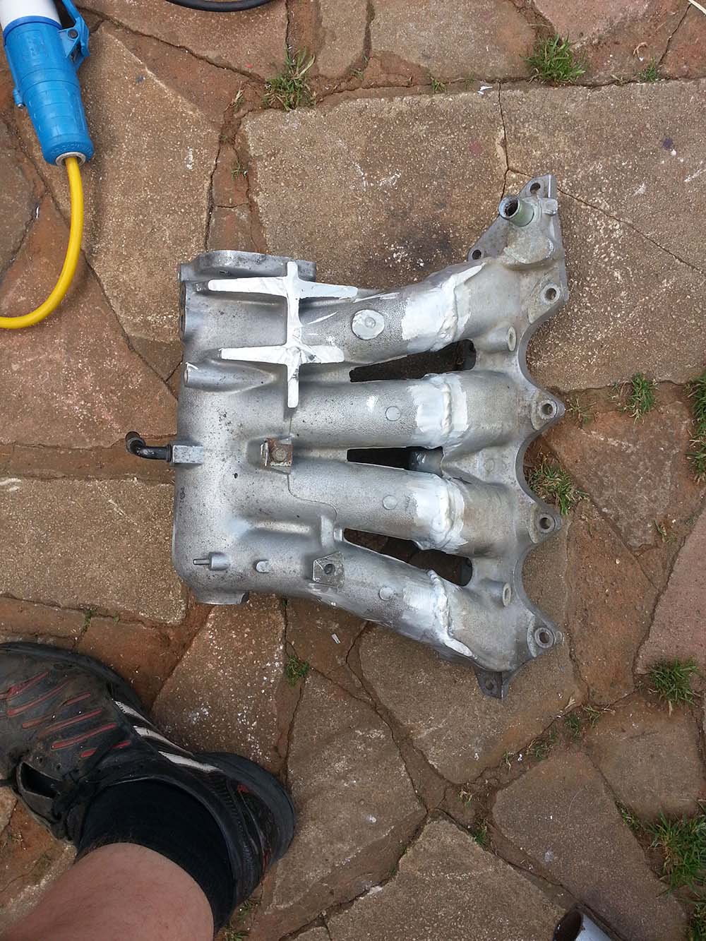

dont think this turned out too bad,
there is a couple untidy bits, one where i managed to poke the tungsten with the filler rod whilst re positioning it, other than that i have not had to adjust or regrind the tip so im happy :)
packing the tig up now before i find something else to weld *happy*

Very nice Brett.
I really need to learn how to tig weld. the guy we share the shed with has one all set up and all I need to do is spend some time with it but that is the one thing I don't have
Welds don't look too bad for a first attempt, especially as cast is generally dirty to weld than clean ally.
It's a bit late now, but welding such thick sections of ally, you are best off chamfering the edges to half the wall thickness. that way you can get deep penetration in the weld, and if you wish to clean up the welds flush with the surface, you'll have plenty of metal to work with beneath the surface.
somthing I found, was use a stainles wirebrush to clean before welding, and ONLY use it for ally welding.
for cast stuff i always end up with the cleaning set tu full ( if you have that adjustment.
also preflow and post flow, especially post flow, keep the argon going for a bit to stop the oxidization
all chamfered where i could on the finished manifold, the flange is slightly wider than the runners so on the inners its chamfered and on the outer edges its built up weld, it used 7m of filler rod *happy*
ill buy a die grinder and m3s as ive been wanting one for a while also a dedicated stainless wire brush,

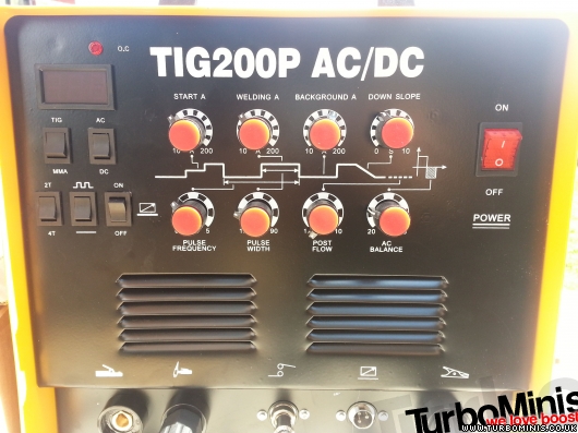

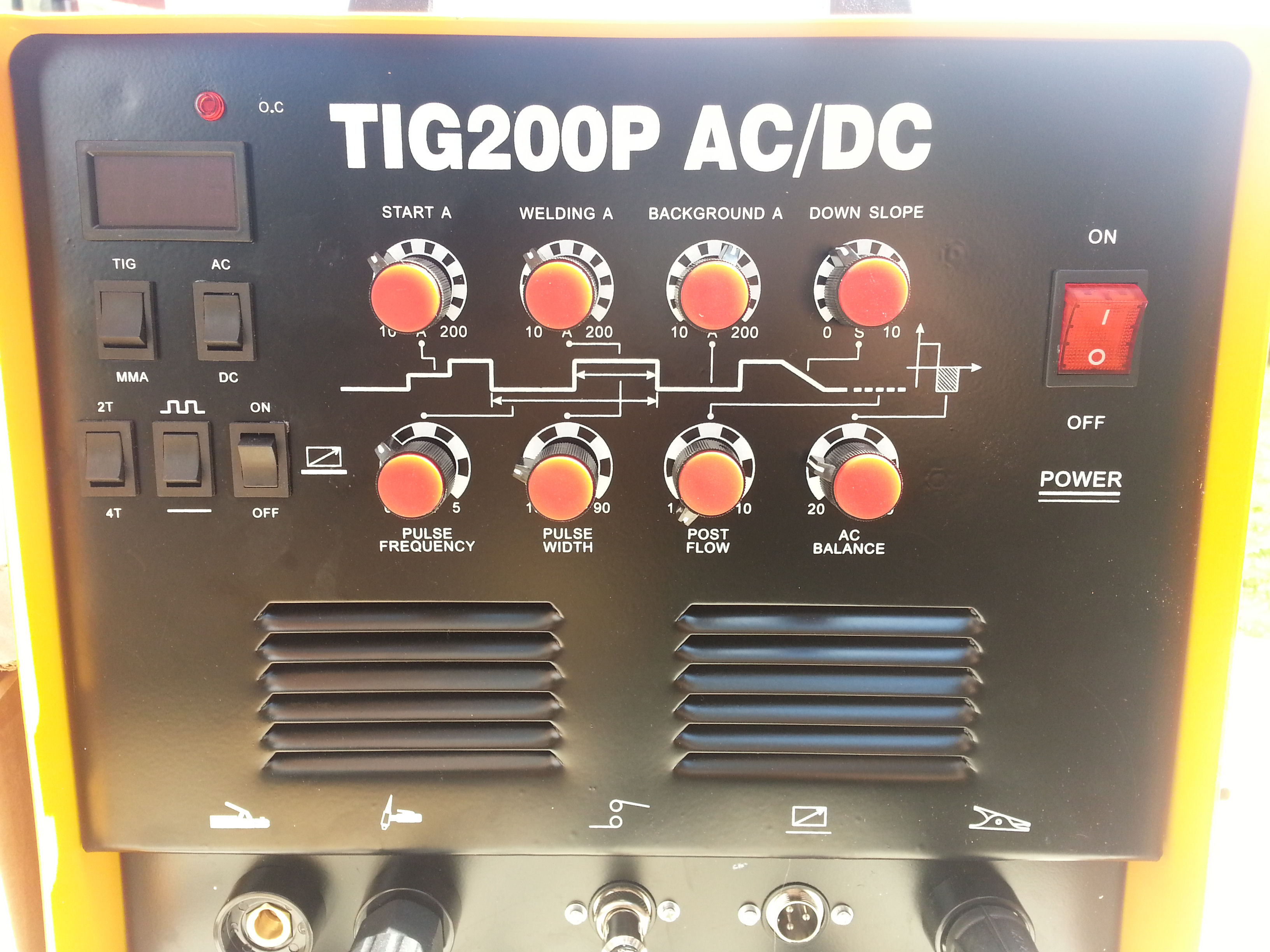

these are my twerly bits, i have worked out what they do, but dont really know what they do if you know what i mean (there not my setting btw )

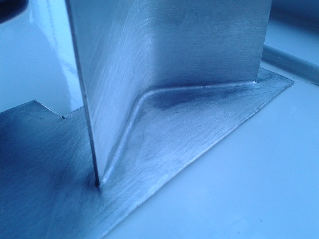

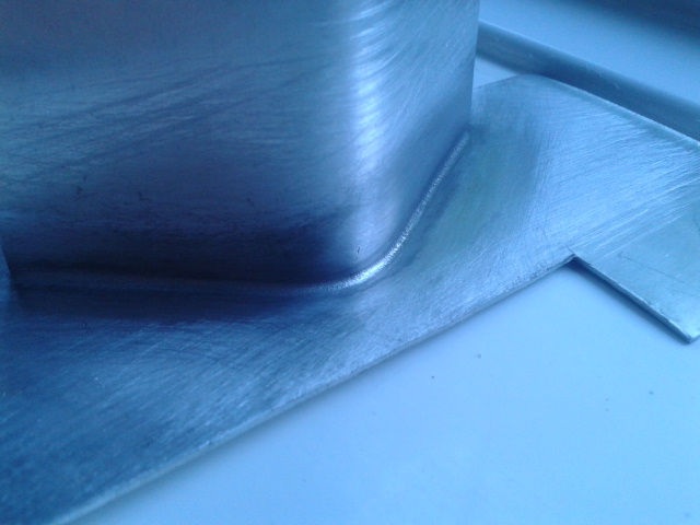

I've got a small job to be done on really thing aluminium, and didn't want to fuck up the part at the first strike, I went with what I already know. I was well impressed with the results of the test piece *happy*
oooh lots of knbs on that!
AC Balance changes the amount of weld cleaning, 20% will be hotter, but 50% will have more cleaning ( current flowing backwards and pushing shit off the weld)
colin thats just showing off *happy*, ill get there
Joe, i did play with that one but it seemed to upset what i already had, seemed to make it overly powerfull but with no temperature at the same time
