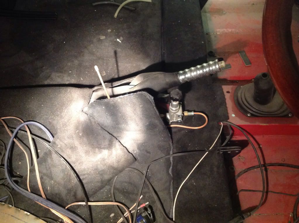

My son has put his at side of hand break

I'm pretty sure that it's not allowed inside the car at mot time.

Ok will pass it on to him and check it out. Thanks

If they can't see it, they are not allowed to move anything.
Same with under trays on new cars, can't check various things as most cars have them fitted.

Can be in the car, just can't be reachable from the drivers seat. So strictly speaking that shouldn't pass.

I suppose it will depend on how the m.o.t. Man thinks about it, in any case will pass the info on to my son. Alan
