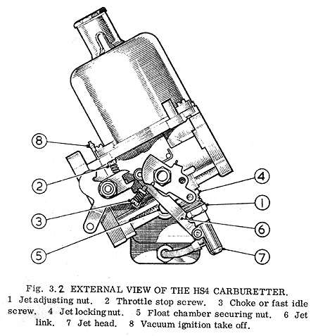

Finally got me engine running but yet to connect the turbo pipework. Here is where I need help. I don't have a clue what I'm doing and most sites that show diagrams and connections seen to directly relate to my setup, perhaps mine is all wrong*frown*
Do I run my dump valve, boost gauge and connection to mega jolt all from the same manifold take off.?
I have a ignition vacuum valve on my carb same as in picture attached (8), at present I have this connected to the manifold take off in a closed loop and it seems to work, do I need to keep this in the loop when or if I tee off for dump valve,boost and megajolt?

Oh and what does the ignition vacuum do.

boost gauge and dump from the same takeoff and I use a separate one for megajolt just so there's no interference, ignition vacuum is for using a dizzy's advance and retard

Thanks for info, so since I'm not using a dizzy I can block this off.? And where is the best place to run a second take off for the megajolt?

I run MJ and boost valve off the same line as they are both installed in the car and dump valve is on its own.

Hi Lee do you any pics to help? Or diagrams that might show how to connect this all up. I still don't know if the ignition vacuum needs b
To be blanked off or if it can be used as a source for anything else? I'm a bit stumped.thanks
