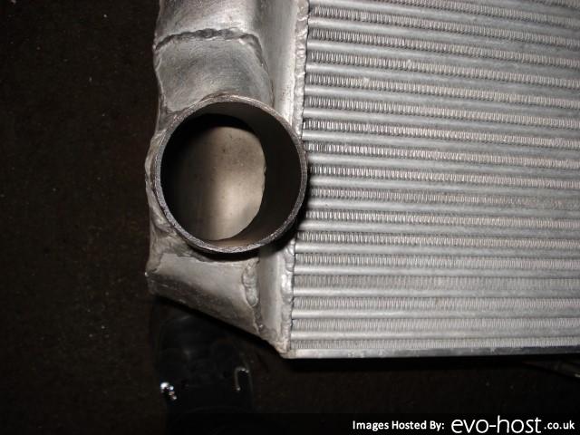

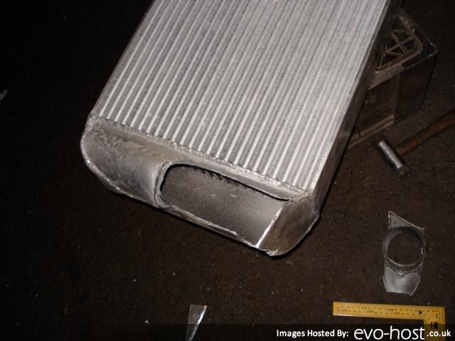

My car has never been run without a filter. Belt shredding incidents are quite messy though
This was the inlet of my intercooler in November when I took things apart for changes
Ignore the silver bits, that's from cutting it open. But inside the tubes were also coated with the black crap
In short lots of dirt got through. The outlet side of the IC was almost clean, so most of the dirt got caught in the intercooler. It took some cleaning.
