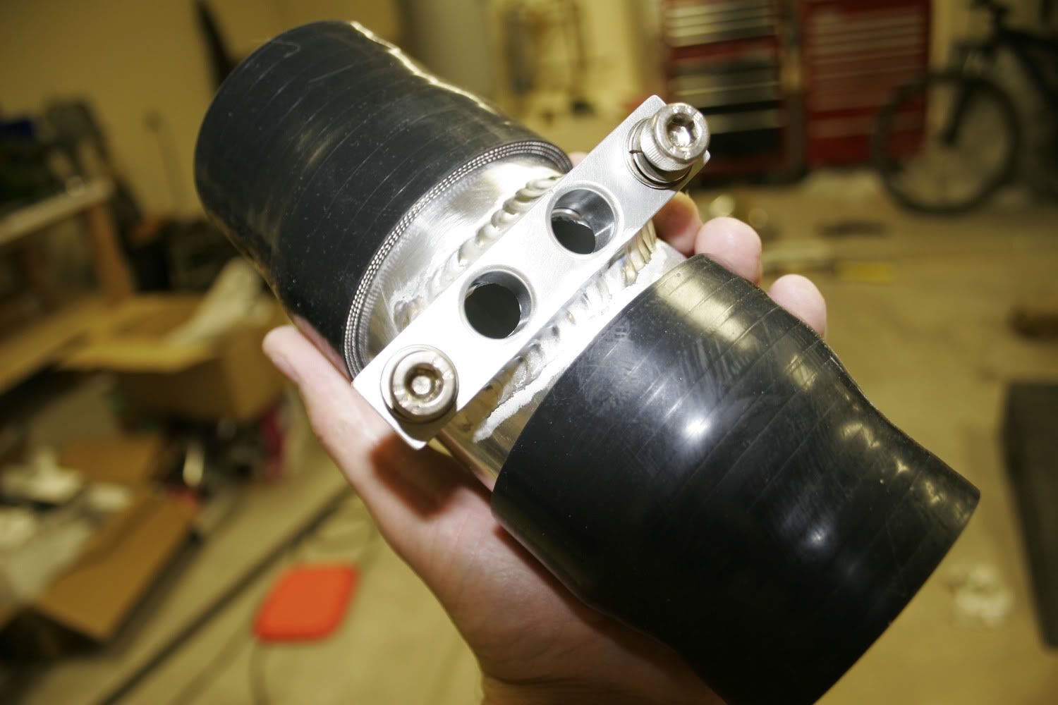

what about just fitting an throttle body, and adding two injectors to the pipe that links the throttlebody to the charger?
http://www.carldavey.co.uk/product.php?id=18
http://i359.photobucket.com/albums/oo34/dj...sn/upclose1.jpg
etc. i doubt your going to find a TBI setup that will meet your needs.
Denis O'Brien.
The sc EFI 5 port kit, has a twin 440 injectors. I'm running and so is Andy on out suck through setups
http://s359.photobucket.com/user/djuosntei...close1.jpg.html
