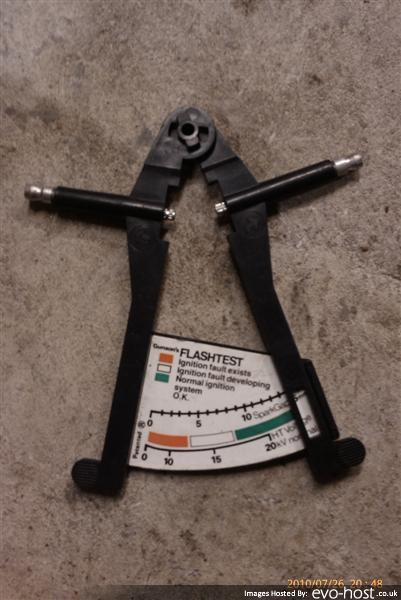

Gunsons used to make a great little tool, sadly they seem to stop selling some great items.
It can give a very good indication of spark performance
Any decent system will easily jump the gap when fully open
9.85 @ 145mph

hmm, wouldnt be hard to make up,
see how far it jumps, 25kv per in isnt it?

Although it does fezl like power is weaker... ( must have it set up more proper because now i just turned it to the highest revs... but it sits with the vacuum al the way to the right hand side ( when looking at it so left when sitting in the car) pthatem is in belgium there are not that much garages who still can set up a old car... time to buy a timing gun) as for the gunson tool.. there is a shop who sells new old stock stuff from them.
Not honestly sure.
I know that a good system will jump that tester with ease, even if you open it up beyond the markings...it'll still fly across
I wouldnt like to get a jolt from a modern ignition system. Some of them carry a hefty punch !
