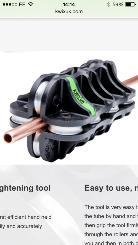

One of my pet hates are wiggly brake lines, they look terrible. However up till now it's been a tedious job to say the least straightening the pipe off the roll 4" at a time using my bench vice. I had previously considered making some kind of roller straightener but that's as far as I ever got.
Until I came across this the other day;
Now like many of us I love buying tools so it was a foregone conclusion. Ordered in the week it arrived Friday so I rushed out to the garage to try it.
Only one word, MEGA!
Roughly straighten by hand one end of the coil just to allow you to feed it in the tool. Then run the tool back and forth a few times and hey presto, perfectly straight brake pipe ready for careful bending with a bending tool to shape.
Cost just over £40 direct from the manufacturers but having looked around it can be bought slightly cheaper elsewhere.
Highly recommended by me!

Just to add , it comes in different sizes for different pipe both metric and imperial. Obviously for brake pipe you want 3/16".

Could you make one for £40? Taking into account my time, I couldn't !!

I think £40 is a bargain if, like me, you want things to look 'right'. I've spent hours, and got increasingly frustrated, by brake and fuel lines and would've welcomed this.
Some sort of adjustable one or a kit would be even better!

Graeme, that's exactly why I bought it, I'm restoring my 205 GTI and want the brake lines to look "factory" standard.

I want one, but as im only likely to use it on one build, so for this reason, Ill do the stuggle. It does look a useful bit of kit for someone who will use it often, or wants a super squeeky look.

I think one of these will be on my wanted list now. As for price, while it is expensive for a tool that is not going to be used much, it will probably be one of those tools worth its weight in gold

there are some adjustable ones available, but neither cheap nor nearly as handy
http://www.eastwood.com/tube-straightener.html

I found this adjustable one.
http://www.viperperformance.co.uk/products...php?xscId=10021

I should update. I've used this loads already! Lisa's BINI needed a pair if brake pipes recently for it's test, out came the straightening tool! If you make brake pipes fairly regularly you NEED one of these!
