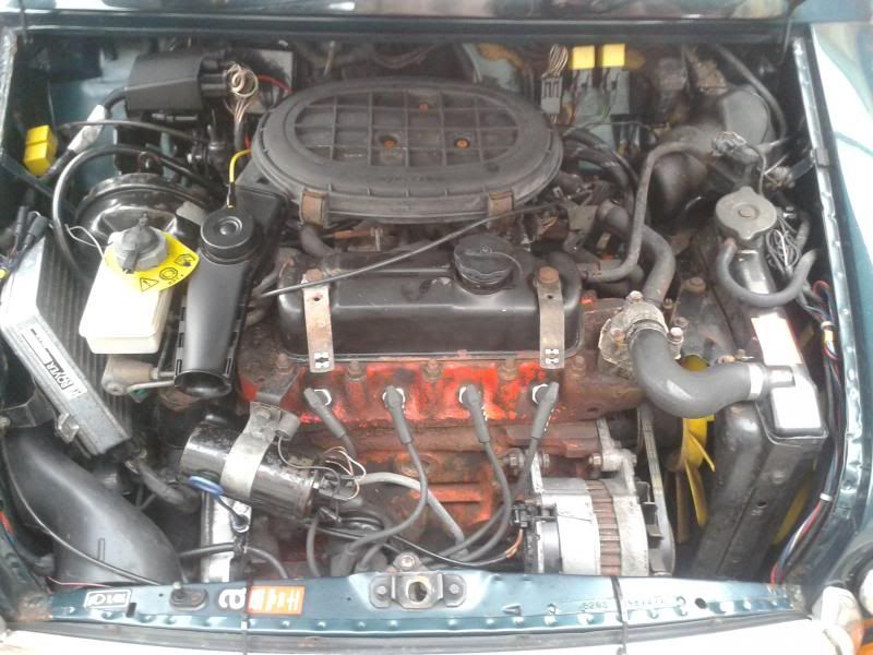

I have a 1995 1275 auto spi Mayfair. I like the injection and I like the auto. I would like some more poke and I have looked at supercharger kits at £1850 and i'm in talks with Stuart from vmaxscart. My current issue is that with it being automatic, it has a kick down linkage and when fitting a supercharger the throttle body is relocated towards the front of the engine bay.
My second thought was to turbo it. I don't want to cut the bulk head and the mirage manifolds don't look to be available any more?
I would imagine that if I can supercharge the standard spi system to between 90-100hp without running lean then I would be able to do the same with a turbo setup?
does anyone know how much boost it will take.
I'm not after a rocket sled, it goes well as it is but 90hp from 50hp would be nice.
here are some photos of the linkage.

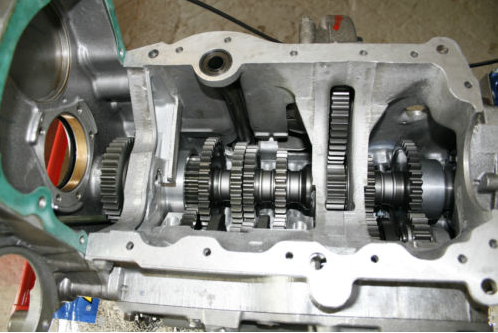

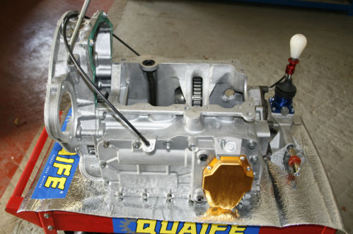

This is a cool auto box
And Martin (MRA) was gonna start building a 1275 turbo auto. but how far this got couldn't tell you.
As soon as you want a powerful mini you need deep pockets!
4309 Posts
looks like a sequencial in an auto casing.
Chalkie
1909 Posts
Member #: 9764
Northamptonshire.
Bingo
