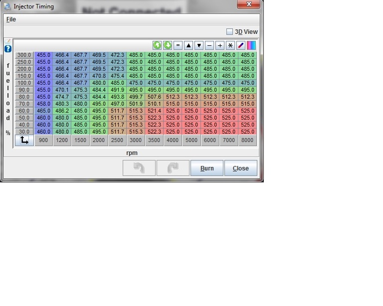

Anyway, injection timing table for a 998 running an MPI manifold and injectors:
We have not ran it at boost yet so the top 4 lines are unproven but based on my earlier boosted 998.
