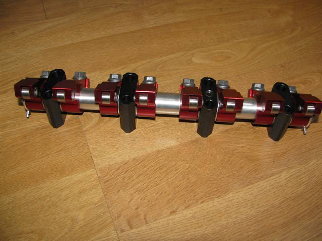

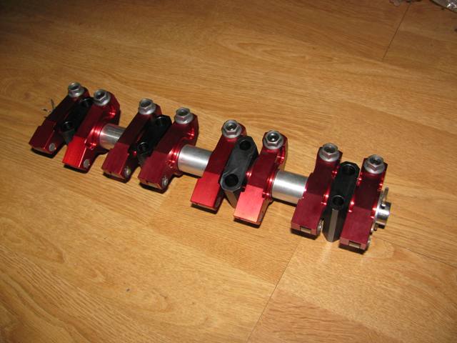

1.3:1 rockers will be great with a small bore. Avoid the 1.5s, too much lift.
They will need spacing and re-ordering on the shaft. Before:
After:
Note the position of the rollers within the arms. Nearer to the post in each case.

paul im assuming the posts dont change there position just the bushes/arms looks like the center spacer is made smaller and some thin ones between post and arm?
Yes, cut the spacers down and put in some large washers. I think they're about 60 thou or 1.5mm thick.
Then re-arrange the rockers to suit.
