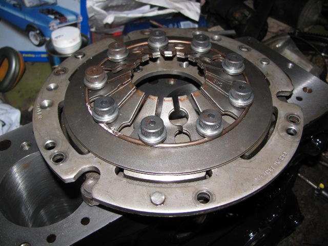

Looking at this thread http://www.turbominis.co.uk/forums/index.p...tid=444733&fr=0 the pictures of a "standard" AP vs valeo are obvious.
But both Colin and Brett say the AP version can come without the metal flat ring on top of the circular ring.
I currently have four of what should be AP, two with the flat ring on top, two without.
The ones with the flat ring are 99% certain OEM, the ones with just the circular ring (and much bigger heads on the rivets) are definately aftermarket.
So, real crappy piccy (only of three of them),
Left is genuine OEM AP, the others are aftermarket.
They shouldn't be Valeo as the rivets aren't triangulated to do what the circular ring does on the AP and the ring is there, BUT, a quick measurement of the OD of the spring shows 5mm difference.
This is all before I take them apart but does this mean that there is possibly "third" version once we go away from genuine APs or valeos ???
The main plate is also different on the non-gen ones, thicker and flat instead of stepped.
Open for thoughts at this moment.
I've just butchered three Valeos. One was like the centre one and two with triangular rivets. One of the triangular rivet's plates was a re-manufactured by National Clutches according to the outer plate that bolts to the flywheel. The other I believe came from the metro van's original 998 IIRC, so was likely to have been factory.

On my phone atm ill have a close look later but at a small glace th far right ne looks like the ap without the ring the far left the ap with the ring but the shiney one looks like a valeo to me

The two picutred on the right are not AP. One is likely Valeo and the other Luk.
HOWEVER, i am finding more often than not, that they are remanufactured items these days.
as you say, the AP is a larger diameter to the others, but the important dimension I would think is the difference in the springs lever ratio.
Interesting.
I'll take some decent photos tommorow.
The two on the right are definately non-genuine, but whether they are re-manufactured or just copies - or maybe some sort of hybrid - isn't immediately clear, hence my seeking your opinions.
The middle one was bought by someone at work years ago from a motor factors for his Metro but it failed its MOT before he got to fit it, I have lost the box but am reasonably certain it was QH, and the right hand one is NOS from eBay and is in a Mintex Don box.
The two on the right certainly have a flat main steel plate rather than the profiled one of the original AP but even then they are different shapes.
I can't accurately measure the lever ratios until I pull them apart.
If the steel plate looks like it has beet shot blasted, it's been re manufactured.
