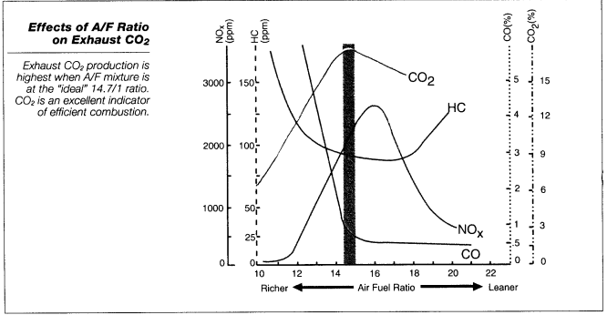

how much co @ idle you aloud? If you look up afr vs co chart it should give you an idea
As close to 14.7 as poss maybe a little richer if idle is poor.
For the mot most will be required to be bellow 3% CO but remember that is an average.
13.5 sounds a bit too rich for it to pass an mot unless its just a visual

Up to 83 is below 4.5% and 1200ppm HCC
After 83 is below 3.5% CO and 1200PPM HCC..
However...I think there was a clause for MG Metro's and some other cars that if they couldnt meet these requirements at idle, a fast idle test was allowed ?
SO it may apply to other A-Series/SU equipped cars ?
As long as the wideband sensor is nowhere near the tailpipe, no reason why it shouldnt be deemed "accurate" as far as displaying AFR's to the best of its ability.
Displayed AFR's cannot be relied upon to be directly linked to CO, HCC, CO2, O2, or lambda though as other things can affect these readings as measured by a proper gas analyser. Like air leaks, misfires etc
In theory though they should.
