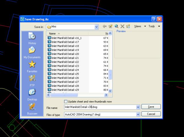

I was given this drawing
So made this pattern from tooling block
