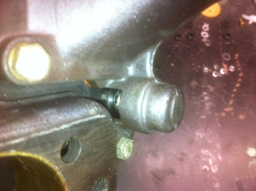

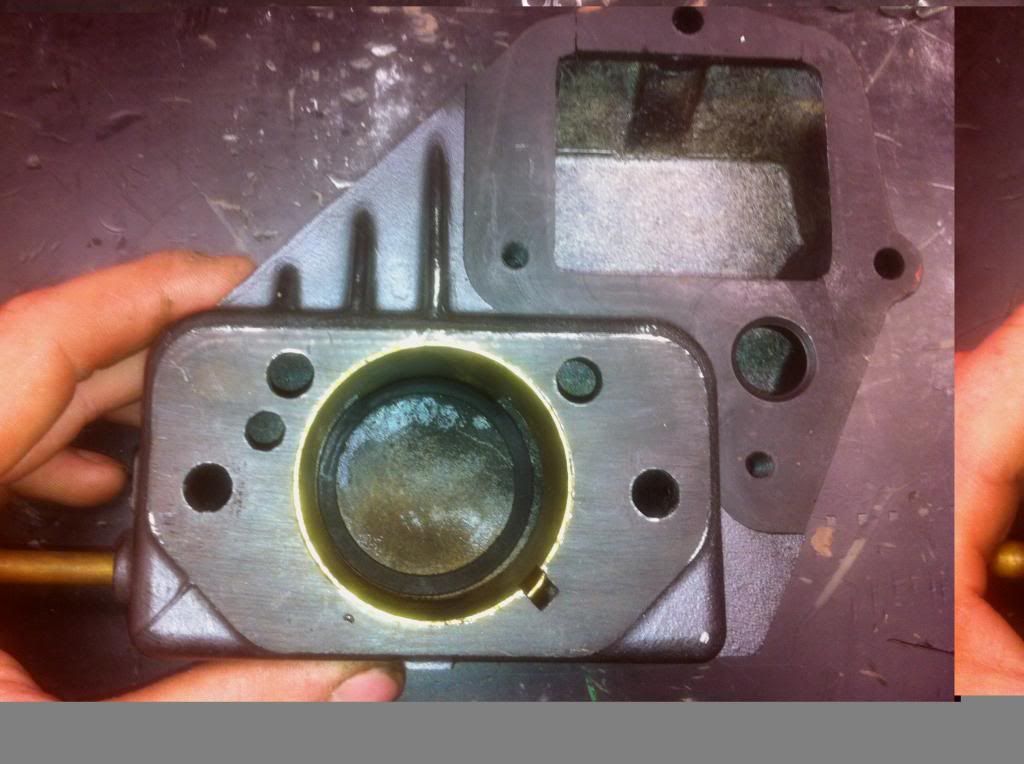

yep blank it off its just a boost leak!
edit: pics for those who may not know what this is about..
Edited by Turbo This.. on 25th Jun, 2014.
Or you can just run a 3/8" BSP tap in there leaving enough thread to fit a blank in there
