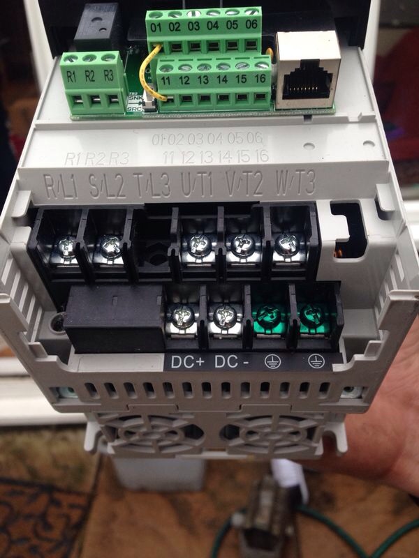

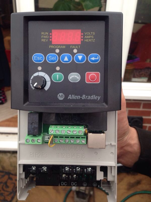

Can any one tell me how to wire this upto a 3 phase compressor??
Any help would be great

r and s will be single phase in, uvw will be your output but you need the datasheet for it to check with the dc tabs it could be a dc inverter... so putting a single phase on rs could make it pop lol

Mike have you bought this as a specific 240 1ph to 415 3ph converter? Or is it just an inverter you've got from somewhere? As it may not do what you want?
Part of the Rockwell group, go here http://literature.rockwellautomation.com/i...e_category.hcst and click on "Drives - Allen Bradley" and select the model.
As Denis says, with those large DC terminals, it might be an invertor.
EDIT - typo

It is a variable speed drive for a three phase motor. Looking at the literature, the only one good for 415v output needs a 415v three phase input, so it won't do what you need.
Itll be going on ebay then!
Shame as I have a massive 3 phase hydrovane compressor sitting in the garage!!!
