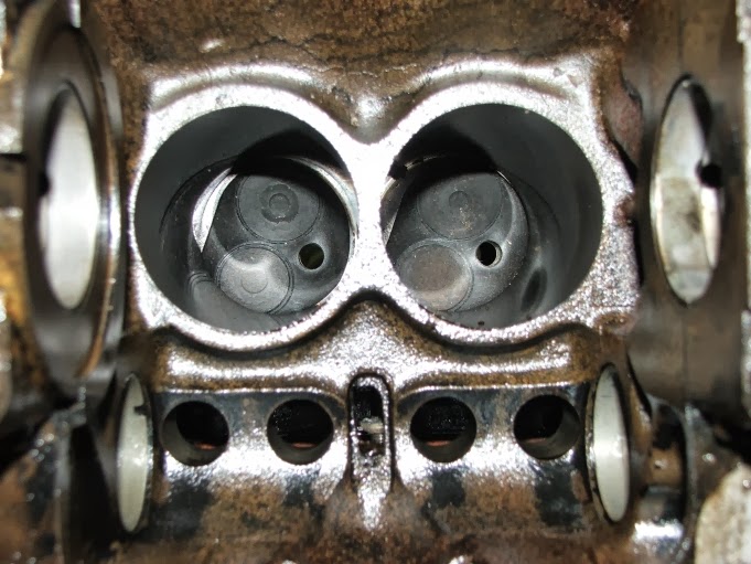

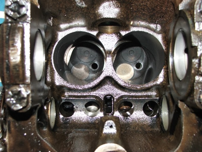

Looking at the pictures of the k100 head on the Mini block.
If that's a standard bore it looks like an offset overbore of 0.120" should clear the valves. Does that seem right?

I got quite a long way into building a 998 k100 engine. Then gave up because the problems were massive.
I was going to use +0.120" pistons to get around the clearance issues, an 850 crank to make the engine nearly equal bore and stroke.
In the end I realised that it was a mugs game as I could do a 998 5 port turbo far easier for far less cash and make more power.
It would have been good for pub points..... last century.

OK I take on board what your saying, what were the other issues besides valve clearance.
I will be happy with a 998 crank as it's just going to be a road engine.
Cheers for your comments this is what I need to get the information I need, I don't even mind small block pockets if necessary.
How much offset were you planning?
