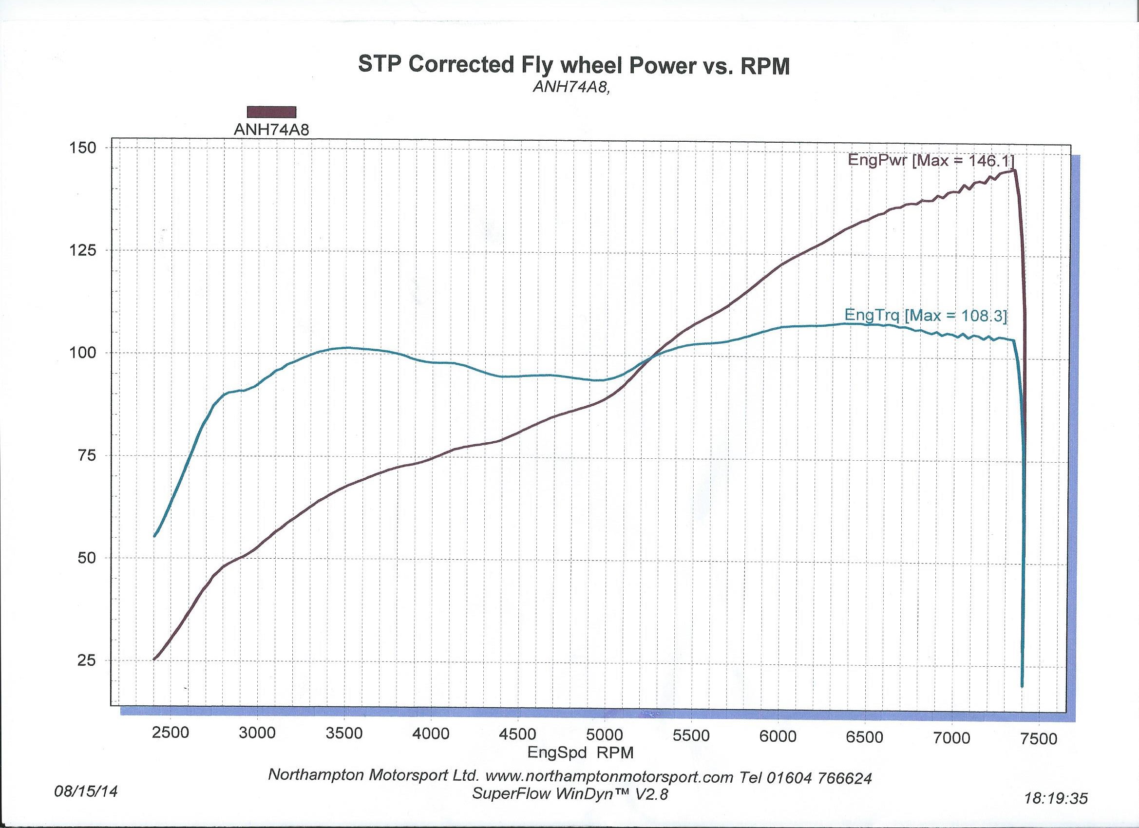

Results from rolling road session at Northants Motor Sport.
Initial results 146 HP (corrected Flywheel) at 7450 rpm 95 ft./lbs ish all the way from 3000 rpm to 5500 rpm with 108 Ft/lbs peek at 6500 rpm (it still wanting to make power at 7800 rpm!) but I was using cheap Halfords 15/40 mineral oil to run it in so I didn't push it any further on the day).
Final 100 degree full on inlet and 106 full lift on exhaust. Using ported head and RS cam spec
There are no real holes in the torque curve ie 3500 rpm ish to 4500 rpm where I have seen others have some issues with the RS In and Ex cam combination. This engine is using very short inlet track lengths and bottom end torque is also very good @ 2000 rpm 65 Ft/lbs and 3000 90 Ft/Lbs

nice figures. expected output for standard rs spec is 130bhp i think so on to a winner there!
Did the power change much when you played about with the lift? Also, do you know what 100 and 106 relates to in terms of mm, using the TDC and dial gauge method?

minited1960
13 Posts
Member #: 10897
Good afternoon all
Please see rolling road results in attachment
The inlet tract lengths are approx 230 mm from trumpet face to valve center line.

nky 84
Yes cam timing was swung on the day and the slight dip in the torques figs you are seeing between 4000 rpm and 5200 rpm was a lot worst in the fist two initial power runs. We were down at approx 85 Ft/Lbs. By advancing the inlet timing by 4 degree (we were at 104 degree full lift) and adding the missing fueling that we should have been seeing this improved it on the day to where it is now.
The exhaust was not moved and remains at 106 degree @ full lift.
