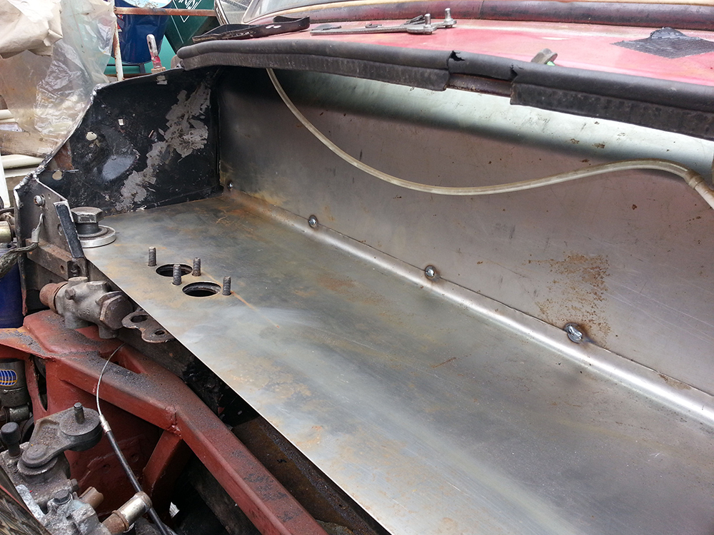

is that 0.2mm?
mine is made from 0.9, its about the same weight as what came out ( but much deeper)
mine in the making -

I've used 1.2mm Aluminium.
Reasoning behind it was I already have a weld in roll cage, mounted to the lower bulkhead head box section and also welded to the A pillers.

Brett... how will you weld this to original flat bit that its sitting on? Any more pics? As id like to something similar to another shell im doing
Nothing gets past Dave lol
Its already done mate ill see what pics I took when im on the laptop
