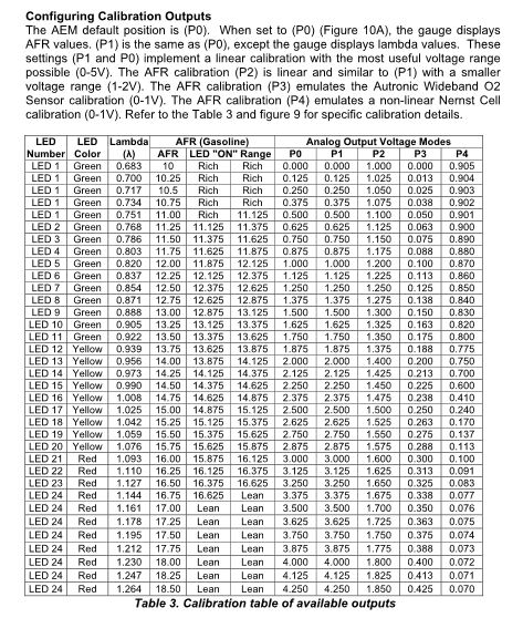

I'm trying to get the AFR gauge in my ECU (SC Typhoon 2) reading the same as my gauge (AEM UEGO Analogue Wideband 30-5130).
The ECU is configured with a table with two columns. Voltage and Lambda. Rows for 0v & 5v.
I can find the voltage v's AFR values quite easily, but can find nothing about voltage v's Lambda.
Is there a way to work out Lambda from AFR?
I have emailed AEM, but wondered if anybody with a bigger brain than me knew the answer, or is better at googling than me.

lambda is a fraction of afr based on 14.7=lambda 1..
so for example ,take 12.5:1 afr
to get lambda go 12.5/14.7=0.85LAMBDA
OR 17:1
=17.5/14.7=1.19 LAMBsydasDA.
That looks like the daddy. Thanks a lot Carl
EDIT: Thanks Robert, it looks simple when you put it like that/ *blush*

andy why not look in ugeo instructions? there is a table afr / lambda for each setting
Not on the instructions that came with the gauge, the ones on their website or the table they sent me. All 3 have volts and AFR only.

its in my pdf *happy*

Brett,
That datasheet must be for a different model, the AEM manual for Andy's model says "0.5 Vdc at 8.5:1 AFR to 4.5Vdc at 18.0:1 AFR" and that table doesn't go down to 8.5 in the AFR column.
Andy,
Easiest way is to put the formula from the AEM datasheet
http://aemelectronics.com/files/instructio...oline%20AFR.pdf
"AFR = 2.375(V) + 7.3125" into a spread sheet and divide the AFR column by 14.7
Here's a spreadsheet I previously made up for the 14point7 calibration, I've just changed the equation to the AEM formula.
It was rounded to two decimal places (because that's what I needed) so I've changed it to three as that's what Brett's has.
Edited by Rod S on 23rd Jul, 2014.
yeah it is, its the data sheet for mine, it still shows afrs vs lambda
Thanks Rod. I did the same thing last night and then scaled my table up to 16 rows (wouldn't go bigger). Will try it later on, maybe even go out for a spin.
