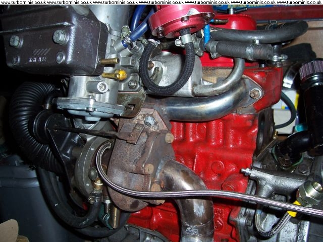

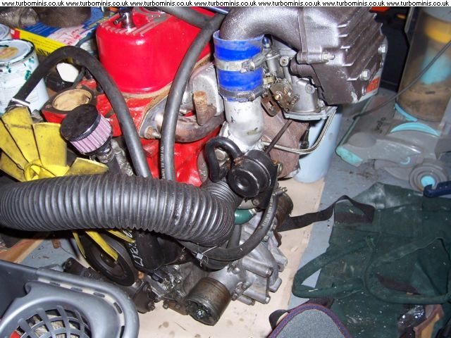

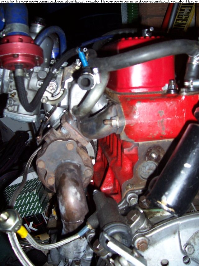

As I have my engine out at the moment I thought I would grab a couple of pictures as a few people have pm'd me about it.
There we are lets see if this works...

Just a note. The mounting bracket with the actuator on will have to be moved to clear the bulkhead.
My green mini already had a bulkhead box so for me it wasnt an issue. I will have to do it for my new project when ever it gets going and i will post some pics of how i did it when its done!
theres some pics too on the link of the bottom of my post, i want to put some new ones on it too

sorry to drag up an old post but to me this looks like you fitted this t25 with out cutting away at the block web if this is the case how did you manage it?
I think it could depend on what comp housing your using,i had to shave a fair bit off,which worried me a tad,
but im using a SAAB 9000cse cold side,
i did think about getting some 3-4mm flange's welded on to compensate.....
retroracer1380
465 Posts
Member #: 1972
Worcester
He had to grind the block
