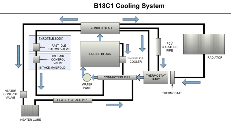

heater tap to turbo
turbo to rad area :L

there is more than one type of heater valve, the valve i would use is the spi one, because you could have this on the heater matrix only
how would i do it? lose the heater imo, on my car the turbo coolant comes out the head and drops back in before the water pump
If you put it back in before the pump brett wouldn't you be putting hot water back into the engine to go through the turbo again? Wouldn't it be better to put it back in after the stat before the rad?

its the stock pluming mate, there needs to be coolant flow even with the thermostat closed
i was going to put it back in top of the rad but im happy to put it back in
(its only like the bypass hose on a 998 or leaving the heater tap open on a 1275 or even drilling holes in the stat )
with my turbo a series i had a hard time keeping a stable coolant temp i thought it was a poor radiator ( and it was shit tbh ) but i fitted the huge rad and it was still the same
i fitted a bypass hose from before stat ( head side) to bottom hose..10mm with a ball valve ( so i could tweek to find a sweet spot) ended up settling on a 6mm restrictor and it was perfect
also to bear in mind coolant pluming on most jap engined are different, they put the thermostat in the cold water inlet pipe ( instead of like in a mini its in the hot water outlet)

im using one on the left as turbo coolant ( as i have no heater and dont want water heated throttle body *happy* )
