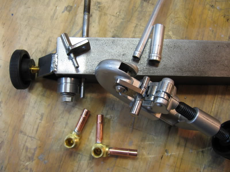

As I used copper pipe (and I'm obviously EFI) I soldered a standard end feed joiner on the end of every line and then cut 2/3 of it off with a good roller pipe cutter leaving just a few mm of the joiner on the fuel line.
Not quite as neat as what you want but totally effective.
EDIT - picture added (not a very good one but only one I have)

Cheers Rod, my pipes are steel however. I think previously the rubber fuel line was just on a straight pipe with no bead etc, prob not the best idea with injection fuel pressures...
Theres no easy answer. I made a small olive and soldered it on.
I put a small flare into the line with a break flare tool. I just started the flare process with the tool and stopped when there was just a bump
