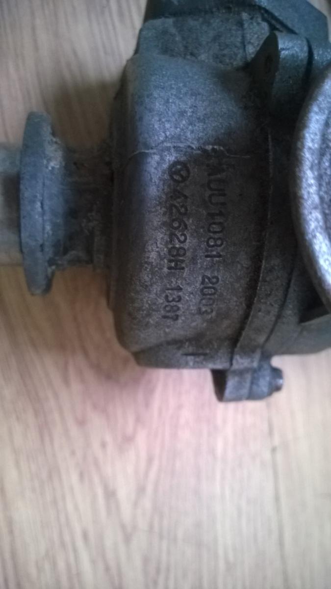

Ok thanks joe :) Il leave that idea for now then, ive been offered a meteo turbo dizzy aswell, will this work ok with the gt17?
heres a picture of it
the std metty one will get you up and running, wont be optimum, but shouldnt be a million miles out.

If you try to start an engine with too much advance it tends to kick. Your best bet is to look for a metro turbo dizzy, or just use a standard one to get you running, and back the timing off a little.
