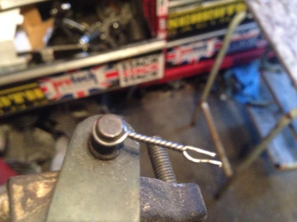

Can anyone tell me the size of the e-clip required for the actuator rod on the gt17 turbos? I've dropped mine down the back of the engine somewhere and now lost so need to get another.

I just use lock wire as I have lost loads. Plus it's much easier.

I've never used lock wire before can you give me an idea of where to buy and how you would use it in replacement for such a clip
I will upload a pic in a min
https://www.youtube.com/watch?v=OwFjUX6SaY8
Here you go mate,

there's some weight to be lost by cutting that lock wire down!
That was just done for this thread.

Did you do that with the proper pliers?
I have some used by steel fixers on a building site. Could probably make that work.
Yes, but I use just normal pointy pliers aswell for some jobs.
