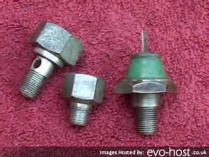

The metal feed uses a banjo style fitting onto the normal oil pressure switch outlet on the block.
This, from memory is an 8mm OD metal pipe which then wraps around the block, 2 x 90 deg bends past the engine steady then over to the turbo, again using a banjo fitting.
It's a bollox to install, requires some bending to install, and is prone to fractures over time.
The fitting at the block is basically a standardish banjo bolt, that is drilled/tapped on the hex so a pressure switch can also be screwed in
The bolt itself is longer than the normal banjo for a non turbo car.
Leftmost is turbo bolt, head is tapped for the switch to screw in.
Metal feed is item no29
