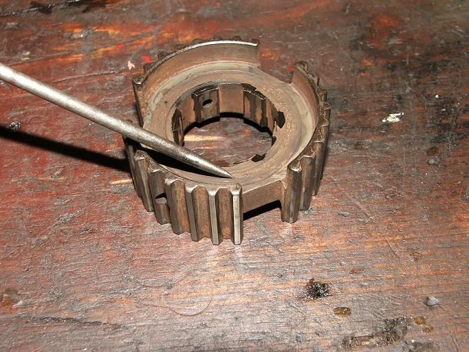

You can assemble one synchronising hub in the wrong direction...

On 21st Sep, 2014 sim_ou_nao said:
You can assemble one synchronising hub in the wrong direction....
oh two ways, 50/50 chance then *hehe!*
should be ok, i left one set of synchro hubs together out of a box so i wouldn't get muddled up *Idea*
