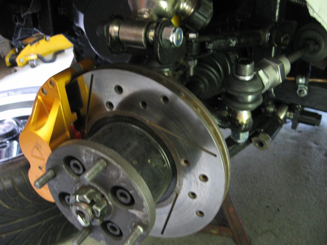

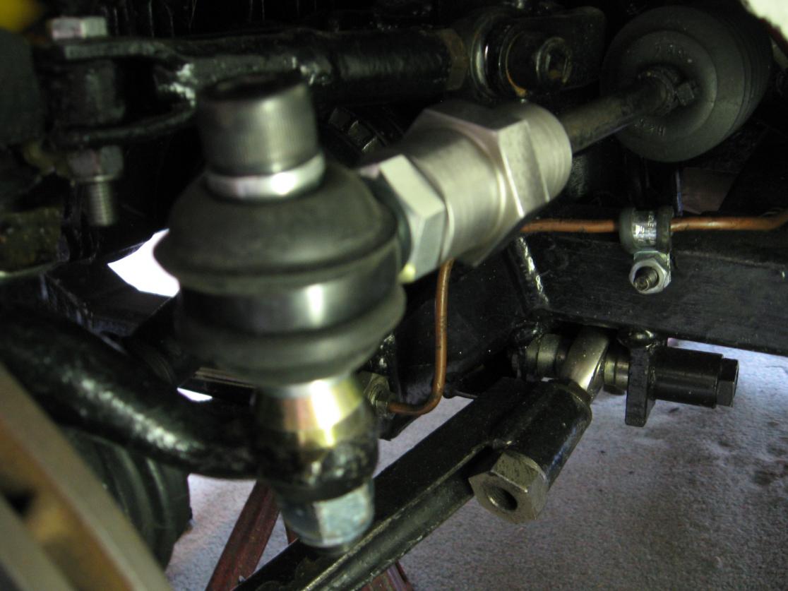

dug these out too from when i was researching suspension geo
from memory these came from a vaux powered mini and could potentially have a moved steering rack
Edited by Brett on 27th Sep, 2014.
