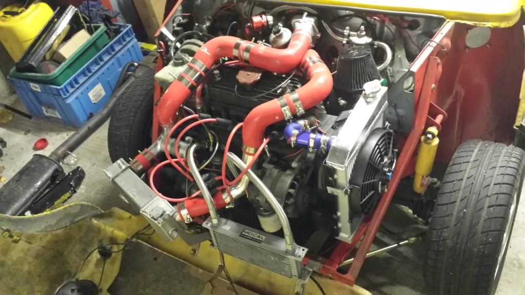

ok il check as im not 100% sure were i have taken it from if i have taken it from the dizzy advance would it cause this issue? by boost gauge fluctuates aswell when i let off the throttle as if the boost pressures going up and down

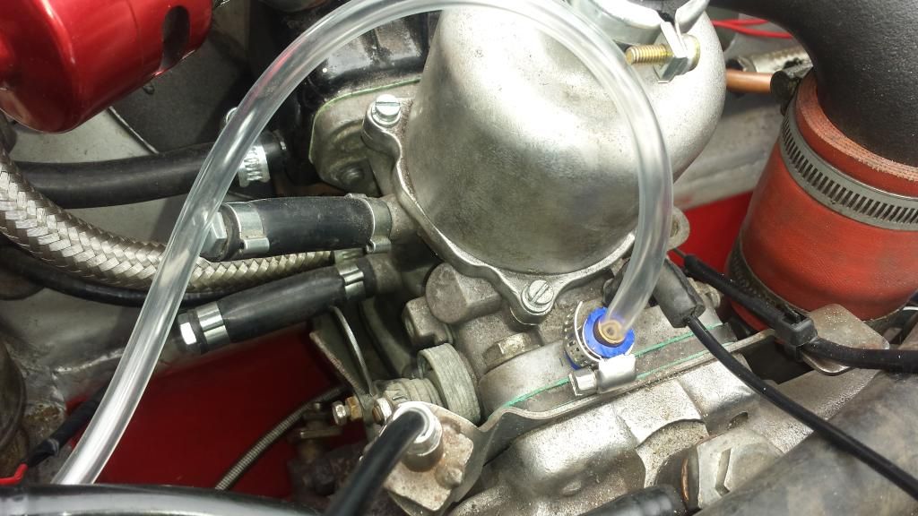

18th Nov, 2014 at 01:12:32pm
This is mine. Bottom left is my boost gauge and top right is vac advance for dizzy.

18th Nov, 2014 at 01:14:17pm
Also yes, my boost gauge raises when throttle closed. I think its due to the takeoffs being the wrong side of the butterfly? mine: http://www.turbominis.co.uk/forums/index.php?p=vt&tid=570945 |

18th Nov, 2014 at 01:51:51pm
thanks for the pics, yeah i think mine is the same and iv taken my dump valve of the same pipe as the boost gauge with a t piece |

18th Nov, 2014 at 02:07:06pm
bottom left should be part throttle lean off (assume you have blocked the other end off) top right is indeed dizzy vacuum.

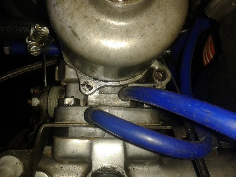

18th Nov, 2014 at 03:35:50pm
Thanks or the replys, the vac pipe i have are relativly small bore so i may try larger pipes to rule that out aswell thanks and il phone up forge etc see if they have a recomended valve.

18th Nov, 2014 at 03:42:50pm
That's the part throttle lean off connection.

18th Nov, 2014 at 03:48:21pm
Think thats your problem... that pipes just closing up under vacuum... thats what my old one did.. have a look at it when revving n i bet u see it suck itself shut Edited by D4VE on 18th Nov, 2014. On 24th Oct, 2015 jonny f said:
