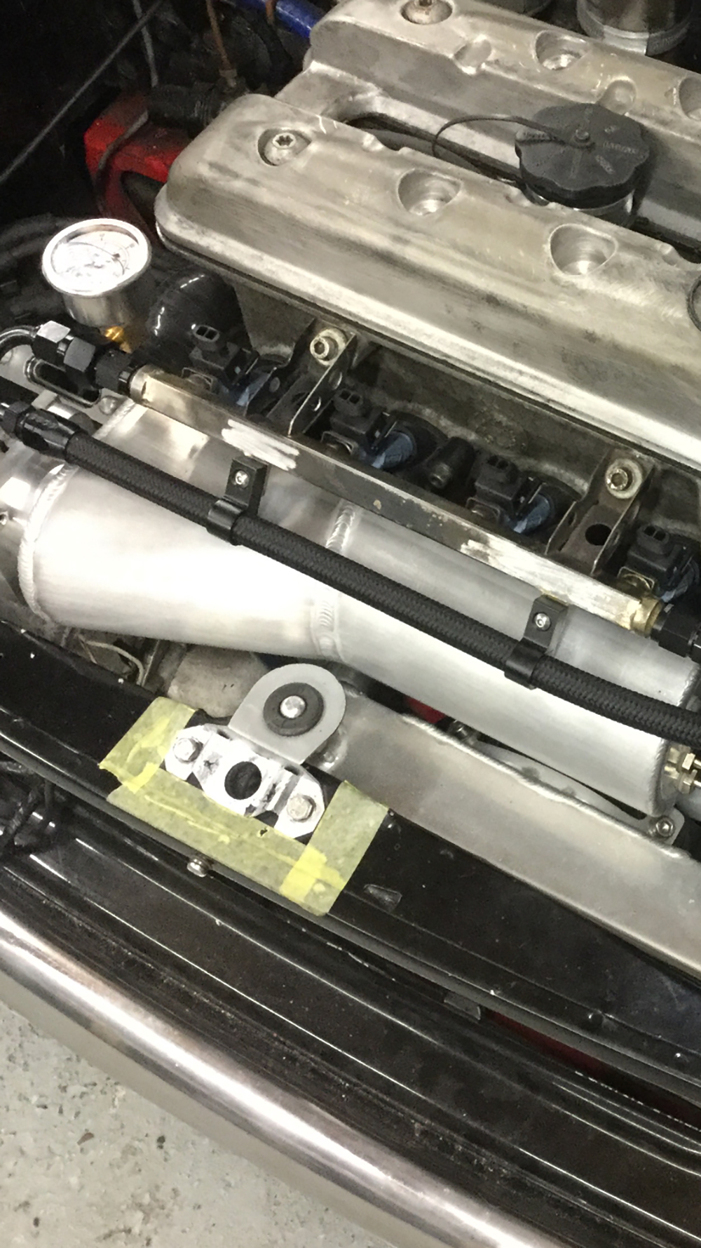

Umm,
Are the k100(8v) and k1100 rails interchangeable?
Edited by Joe C on 7th Jul, 2018.
shane
2646 Posts
Member #: 1246
Lowestoft, Suffolk.
No, the 16v has a more pronounced stand off spot welded on. The 8v sits closer to the head on account of the differing injector position.
Excuse the poor picture, it was from from when I was first toying with an 8v many years ago.
Shane
Edited by shane on 7th Jul, 2018.
