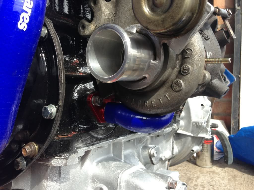

I used the Saab V band and rubber seal and turned up an aluminium stub long enough to take the silicone hose.
On an earlier car I did what our lizard friend says - I think I still have one of those Saab inlet pipes kicking around.

This is the stub mentioned above.
