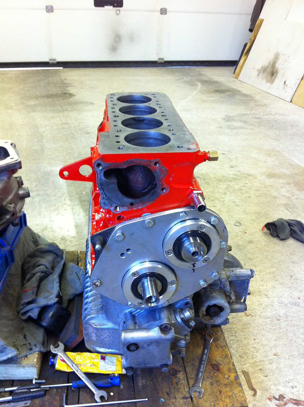

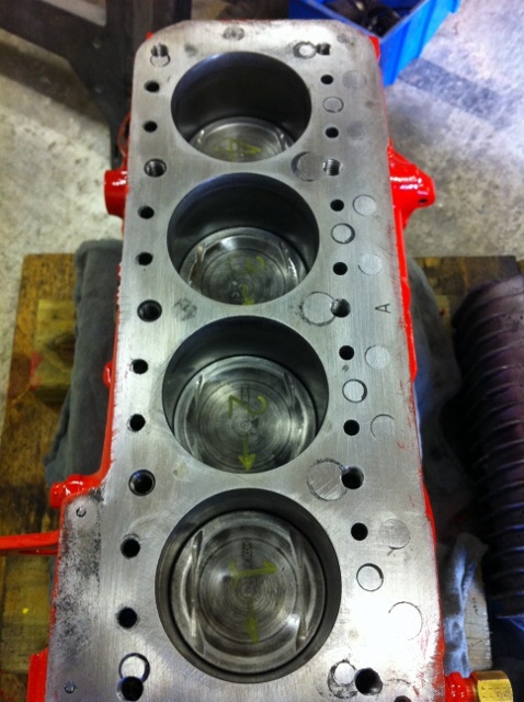

Here's a couple of pics of my 'DIY ' build
