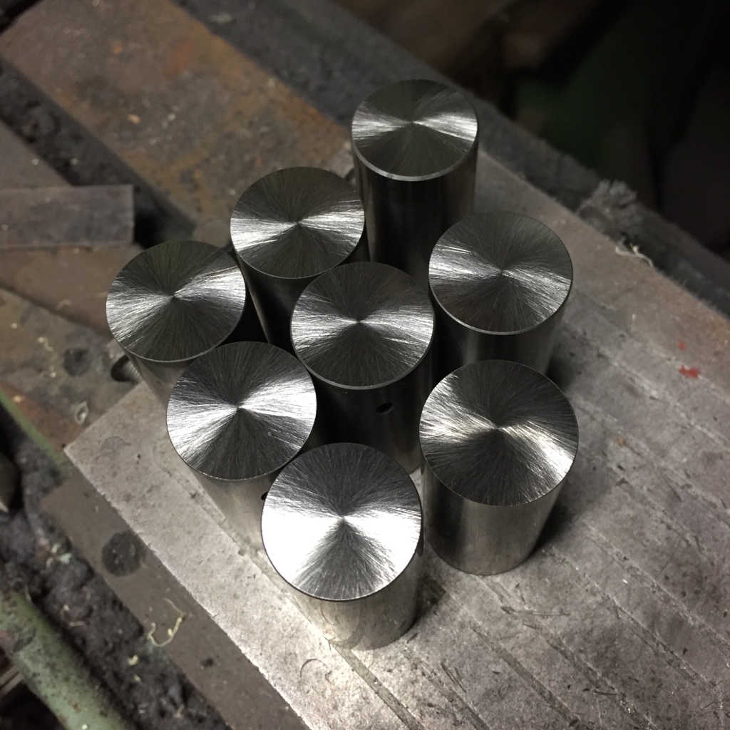

My mate Graham Russell alertedme to somebody on here talking about the crapcam follower issue we have all been suffering with for the past umpteen years... I now have the solution. After years of brow-beating suppliers & manufacturers and getting nowhere, I decided the only way to solve the problem was to do the damn things myself. So I bought a cam follwoer grinder. Not at all easy, finally finding one in Australia. Shipped it here and is now up and running. Perfect, precision ground cam follower faces with the correct profile for correct rotation in use. I can do new and good condition used followers for all and sundry for a small fee. Sorted.

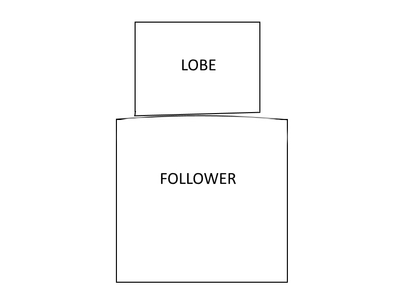

dont cams lobes have a slight angle on them for lifter rotation?
Yep,
this should give help visulize what happens, also the lobe is often offset in relation to the follower to help rotation.
imagine if the follower was flat, the cam would contact right at the edge, so there would, be a point of high pressure so the oil film would break down.

thats awesome joe
clear as day
makes sense with the oil film as well its like dragging a cube across sand vs a ball
the ball lifts and drives a "wedge" lifting it up vs the sharp corner with a shearing

It would appear so. It seems there aren't that many companies that manufacture the followers (like 2-3) and then supply to different companies.
i have looked at the mass produced ones, a couple of old sets and FLAT. when a picture is taken of followers with the radii you can see the conical swirl, .photo courtest ausmini, tim w hope it is ok to share

Cams tend to have a very slight angle across the lobe - typically about 0.0007". I have my cams ground with a bit more than that to aid follower rotation.
A-series followers are supposed to have a radius on the face in the lorder of 52-82". Not much, but is absolutely essential for follower rotation. If the follower does not rotate then premature wear of follwoers and cam will be guaranteed. The followers are also at an angle in the block. Only 2 degrees but it is all done to ensure follower rotation.
The followers available from all the usual suspects come from one of two manufacturers. though the vast majority come from just one source. The follower faces come in all kinds of finished shape - everything except the correct one it would seem. Some are dead flat, some are flat but angled one side to the other. This has been going on for years now. I have tried time and again to gett he manufcatiurers to understand the problem. Seems they don't give a damn. Neither do the cam manufacturers. Better for them if things wear out quicker.
Isky followers have not been made for years. I believe they were manufacured for Iskenderian by Johnson Bros. in the States. I tried to get them to remake them years ago, but they were not interested. Too small a quantity it would seem. The ones MSC sells are 'Isky style' but are made by the same folks that amke the vast majority of the other followers. MSC also have followers made by the now Federal Mogal owned AE. I believe these are probably made in South Africa.
The followers available are not as good as the OE ones that were made in the UK. The cast iron is nowhere near as good a quality. But they are OK except for the face profile. Hence me investinga serious amount of time, effort and money to get hold of a proper cam follower grinder.
