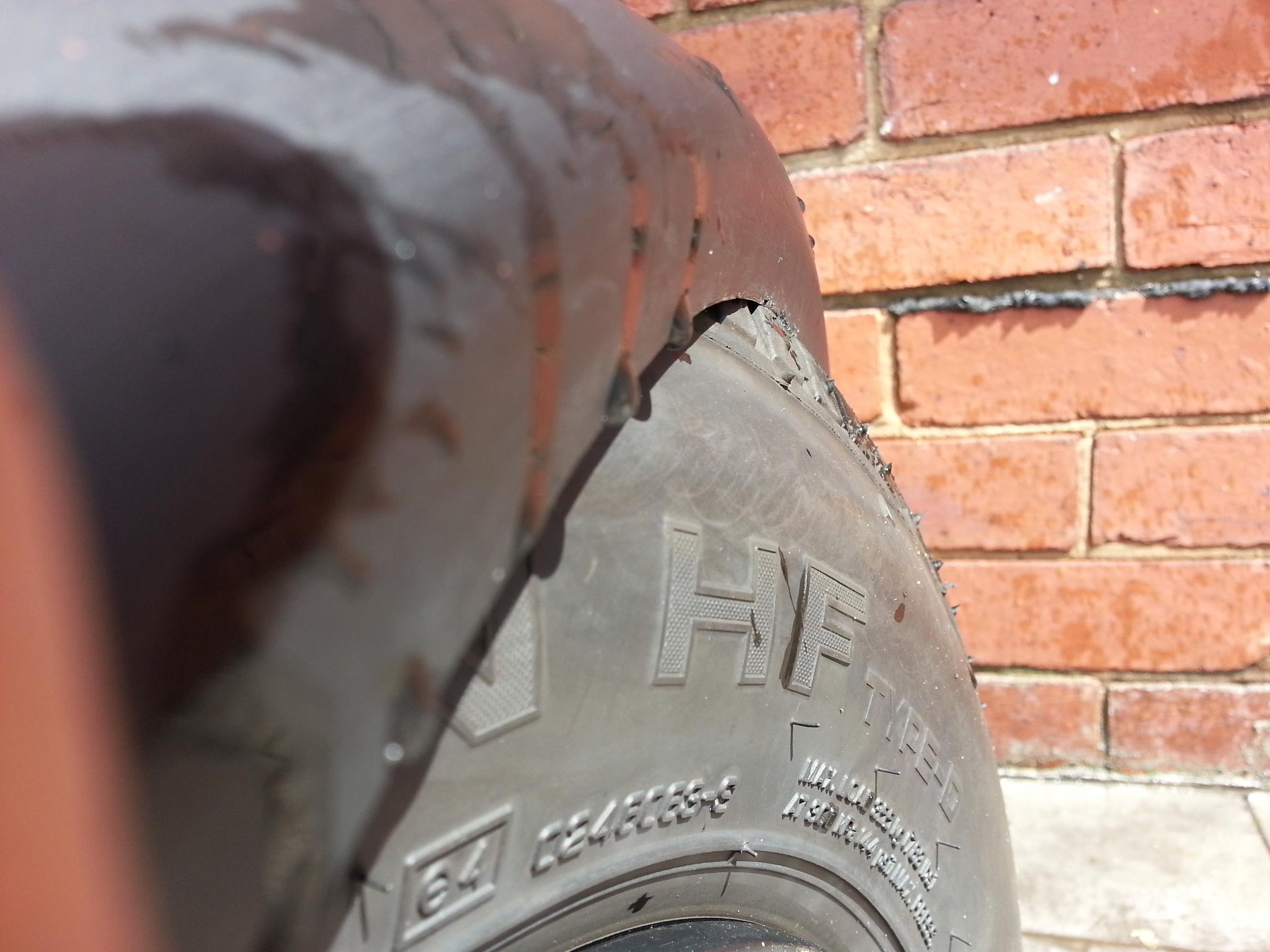

Not the greatest of shots, but that's about the limit for the std height dampers on Shaunas mini:

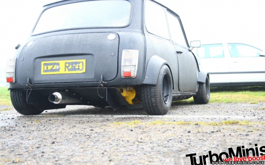

and while were on the subject of low one of my favorite pics
6753 Posts
i imagine spencer having some sort of ocd design crisis ,covering his eyes with one hand and screaming as he fumbles for the off switch .
