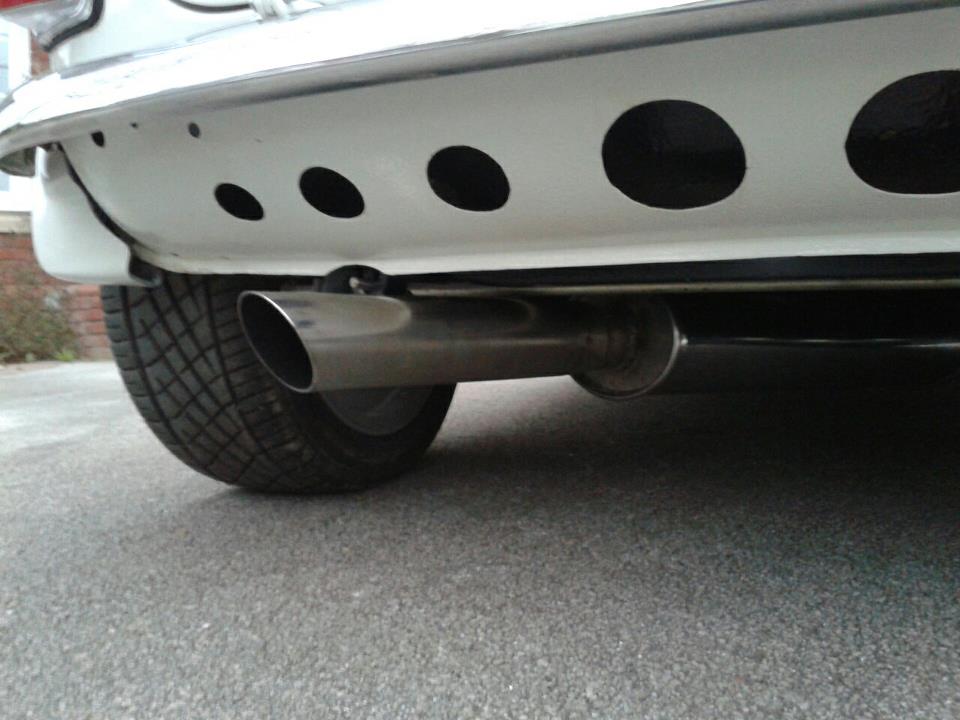

I'm after a picture of either an MS or KAD anti roll bar with a centre exit tail pipe. All of the pictures I've found online are taken from the ends where the linkage is.
I'm trying to work out how high I'll be able to package my silencer with the underslung type bar.
Best I can do at the moment.
This is the Minispares road ARB, but I used poly mounts similar to the KAD ones and welded the threaded plate to the subframe. I positioned it as close to the rear brace and the bar sits probibly half its diameter lower than the rear brace. You can see it in the pic as the light coloured strip. you should have no problems with a centre exit exhaust as it sits low anyway, my side exit just about fits, I had to make it sit a little lower at the rear.
