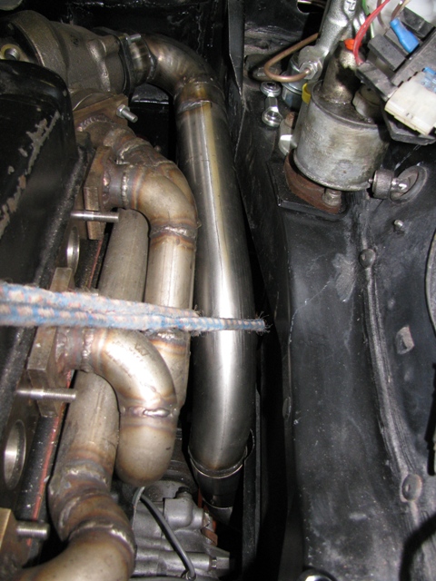

I did expect to make up a special oval section piece to pass the pot joint, but I can get a 80 Deg bend through the gap with plenty of clearance.
I think mine is a later subframe, in fact, I know it is as it came of a 93 car.
It's all stainless stuff which I am going to TIG. Side mount turbo.
I plan on making a link pipe to the same shape as a 2" pipe that I have laying about. Hopefully will get past the shifter without going too low.

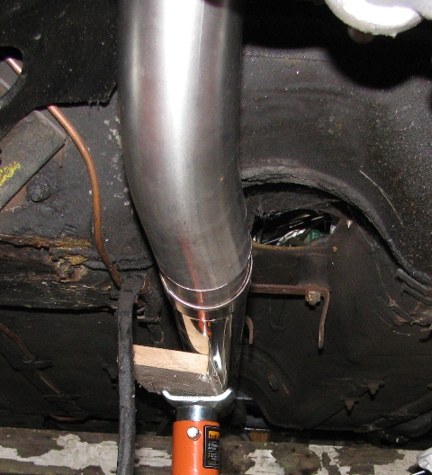

Well, it all fitted together OK. Just tacked at the moment but just enough clearance:
worth trying it with the gearlever in there before final welding paul?
