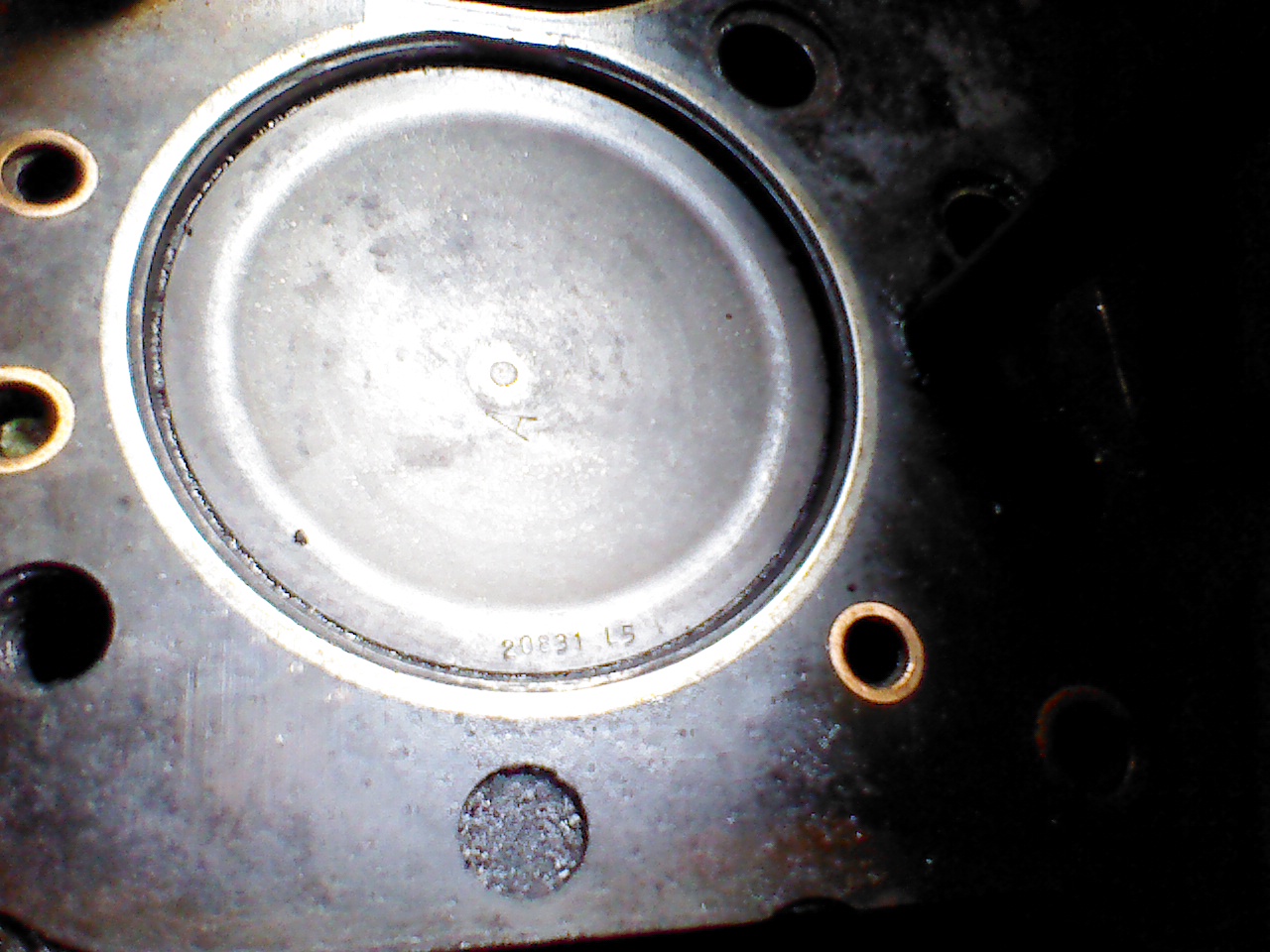

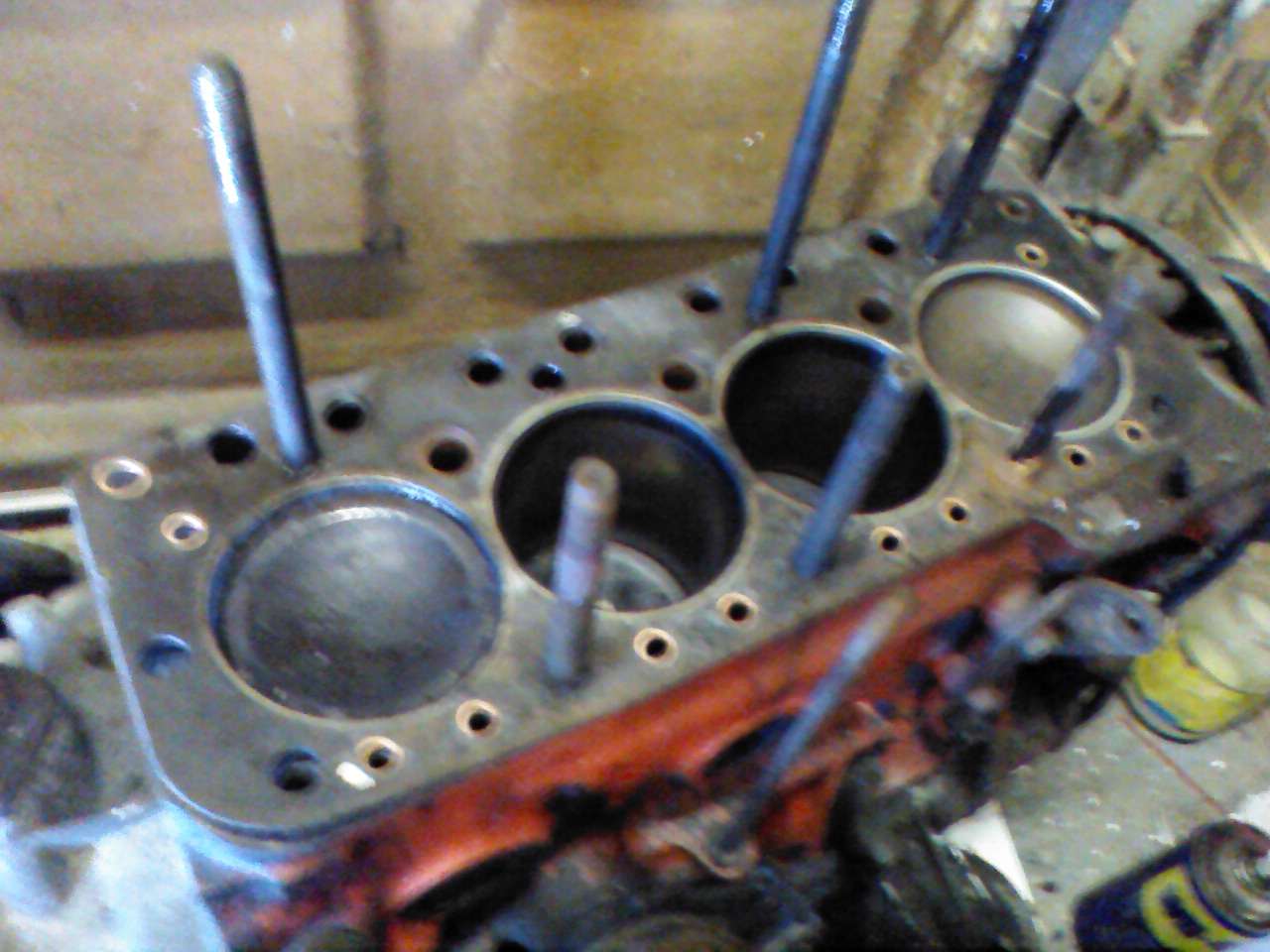

Just nipped in the garage & removed the rockers & cylinder head, bores & pistons don't look too bad for an engine that's sat in a garage for 15years.
Plan on a rebore +20thou, omega pistons, reground crank - just need to decide whether I need a steel centre main cap & undercrown oil cooling jets... Hmmm

They're easy to do so why not *wink*.
Lets see the van?
a centre main strap is advised and under crown cooling jets are not needed. but if they turn you on go for it

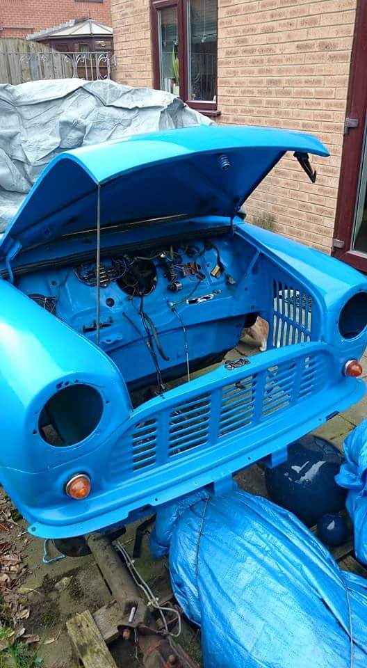

The van on the patio half way through stripping and getting ready for the bodyshop.

Good luck with the build, van looks in fairly good condition (what we can see of it)...

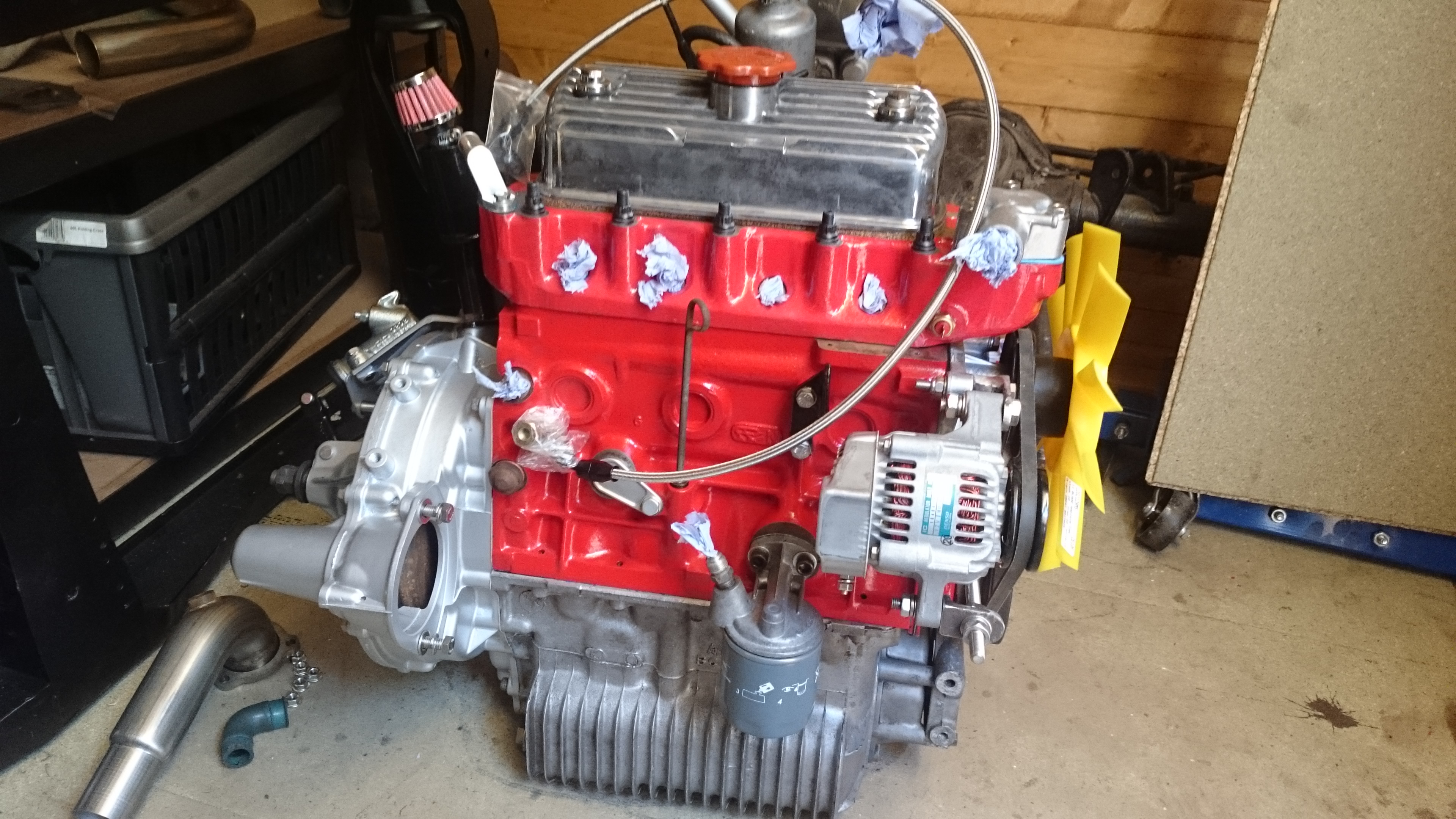

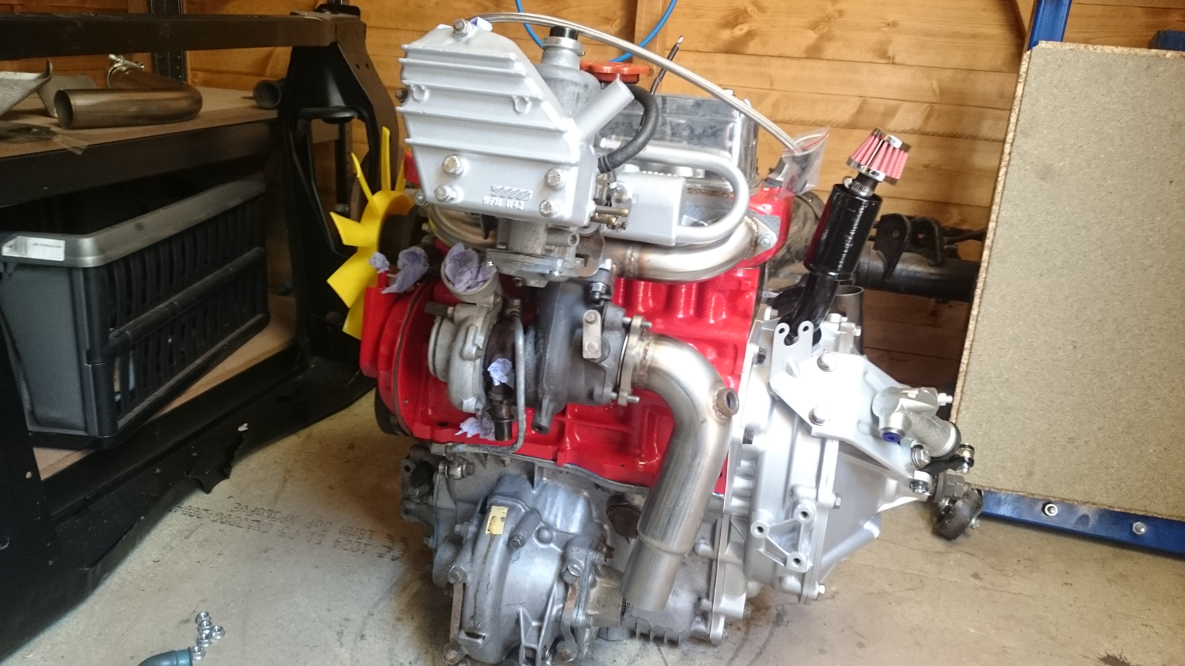

Well engine finally ready for the van, but van isn't ready for the engine! Couple of months I guess, all that's left is to sort pipework and intercooler, Megajolt.......
Spec:
Original turbo engine and box
Benross cylinder head
Kent 266 cam & duplex gear and chain
+20 thou rebore
Omega pistons
Arp rod bolts and head studs
Fully rebuilt gearbox with new Baulk rings, and 2 big brgs
Minispares X pin diff
2.95 final drive ( to keep 10" wheels and sensible cruising revs)
Matty manifold
Gt1752
