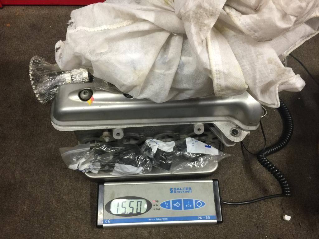

This is head, cams, bolts and cover.
Normal 1275 head weighs 13.8Kg, I guess approx the same, inc pushrods, rocker cover. I don't know how much the conversion kit weighs?

Based on twinkam conversion been 5kg (6kg inc p&p on SC website), I reckon the the conversion kit be about 1kg heavier.

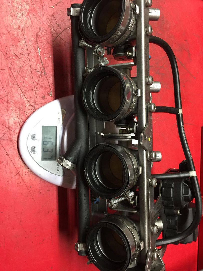

The conversion kit was a bit heavier than i would have liked, you could make a good saving if you hogged out all the unnecessary material in the bottom cover for sure. There saving to be made on the jack shaft too. If done right i seriously doubt theres much difference between the cam drives.
The throttle bodies are closer to 1kg once you have removed all the useless bits and the k1200 fuel rail saves you a pressure reg too. They must be a big saving over a carb and manifold or 5 port injection?
