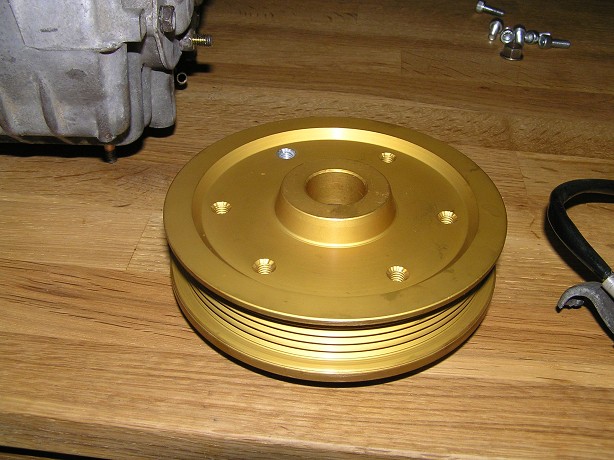

MSD Boost Timing Master
That's a nice picture of my Kitchen Table you have there.
notabmw1
22 Posts
Member #: 10615
Maryland, USA
I nabbed it from your build thread I believe? I wasn't really paying particular attention to the kitchen table, but more so the sc12 and awesome pulley! I tried contacting Carl about if still had a file/cost, etc, no word yet. The supercharger I got has already had the clutch pulley modified to be fixed. But I am sure it does not have the weight savings as yours!
