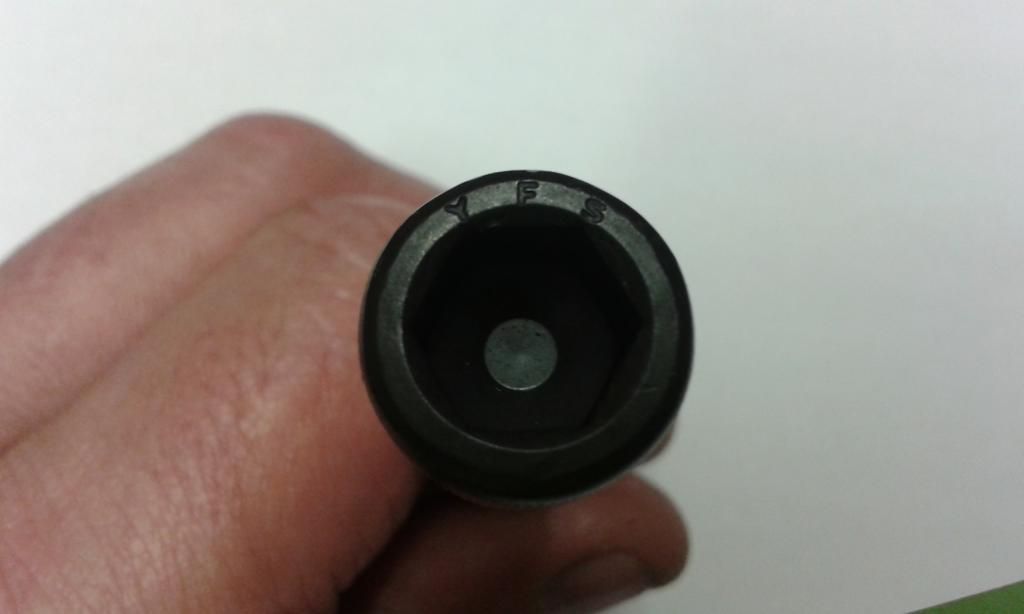

The bolts you have.. do they have dash marks on the head?
Post us a picture
Indeed if they are cap heads and 12.9 dont worry

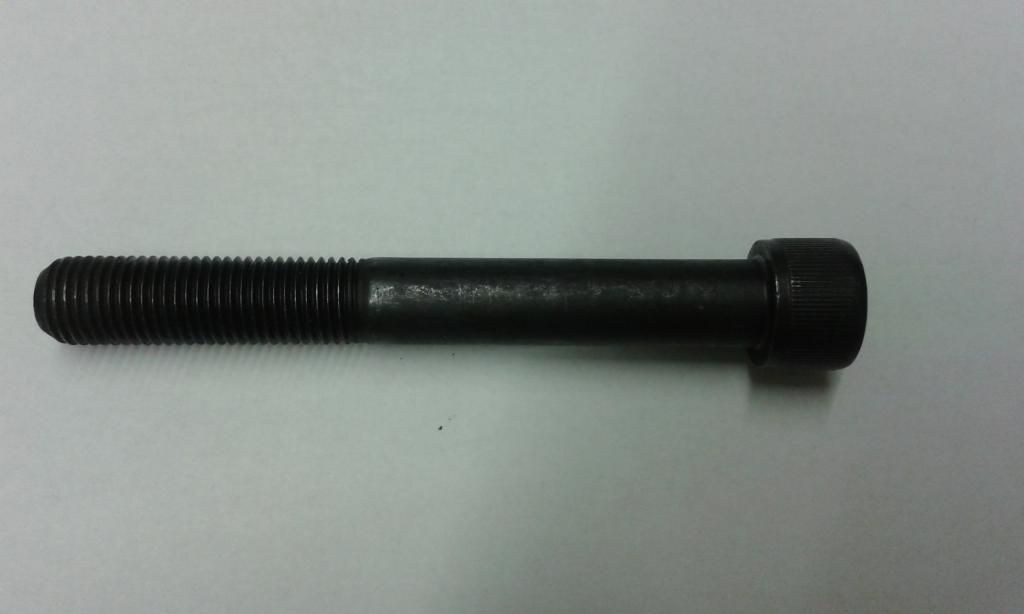

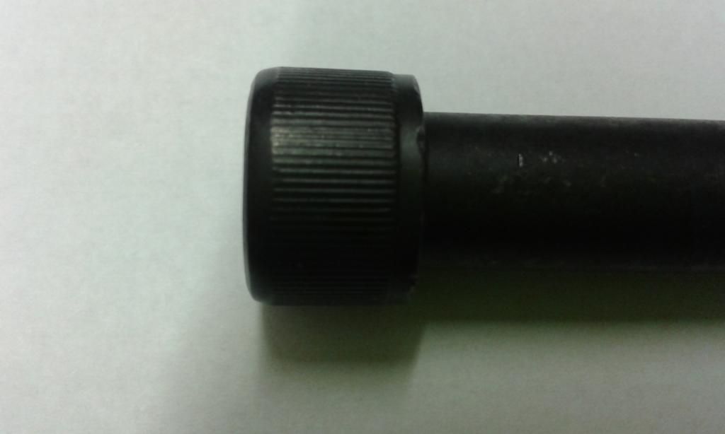

not sure if this will work this is top of bolt
tony 69
134 Posts
Member #: 10548
chesterfield
side view

PhilR
696 Posts
Member #: 10034
Birmingham
"... YFS products are manufactured from high tensile Alloy Steel, Class 12.9 and ASTM A574 for industrial machinery, electric appliances, automotive vehicles, military equipment and may other industrial products. YFS offers the highest quality fastener in the World, meeting all the manufacturing standards globally..."
(From their wesite) It looks like they only make 12.9 cap heads.
Edited by PhilR on 31st Jan, 2015.
tony 69
134 Posts
Member #: 10548
chesterfield
Thats good then I'll be using them *Clapping*
