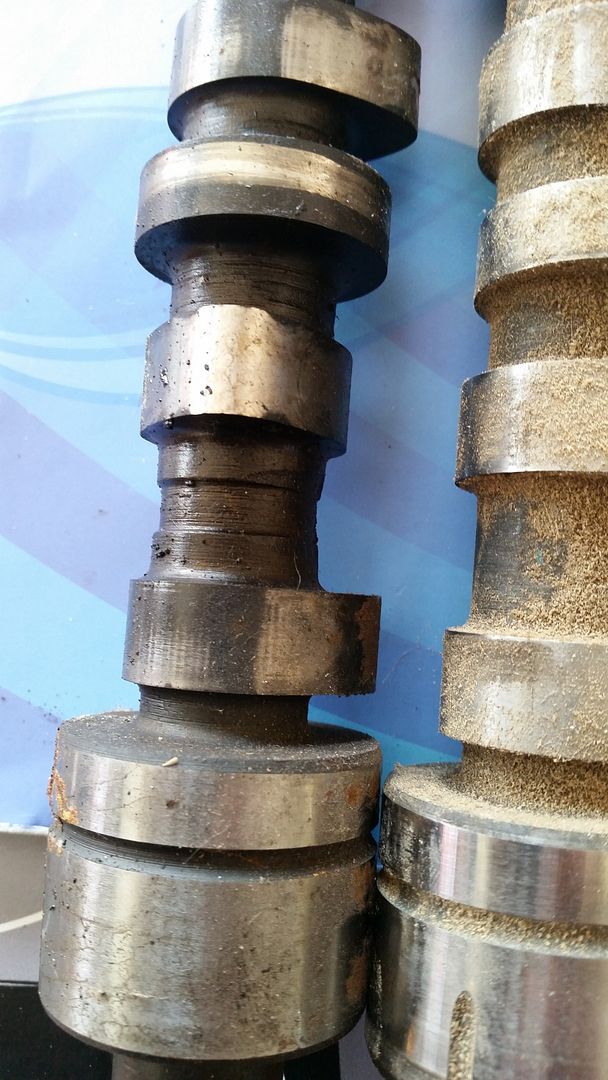

yeah just had a search on the cams.
both are crap ( they are in good nick but... ) i have the standard ( unmarked) cam and the one with the 2 rings between lobe 7 and 8 from a the 1275 sprite/injection cam

and then i came across this. dirty as... but at least i found it back
thats the metro one right? as i can compare here on what i found and on ac dot his website

1275grimsby
147 Posts
Member #: 10874
Grimsby
It has the 1/4" groove which is what I went by.
