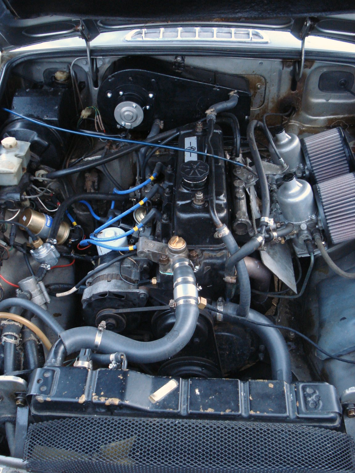

Turbo noob here. Has anyone had any experience or ideas on turbo charging the MGB b-series?
Janspeed did a kit years ago but they seem rare as hens teeth and the moss supercharger is way beyond my budget at the moment.
I'm not after big power but 20 to 30 bhp with extra grunt from say 1500rpm?
Cheers!

The moss supercharger bolt on kit runs around 7 to 8 psi and that is made for stock engines. They are usually regarded as quite tough if running ok :)
Edited by vpmg on 17th Mar, 2015.
If you only want to tickle it then the pistons will be fine. Limit it to 8psi and it'll run all day I reckon.
The B series is a shit old lump, I bet the CR is low enough as standard.
I'd be tempted to inject it, but a metro turbo carb would breath enough for a mild tune.
You'll have to get a manifold made and think about a suitable turbo though.

I'd be happy with anything extra really. It just needs a little bit more omph and I though it might be a more cost effective way than buying a new head + cams etc.
It's already got dished pistons rather than flat ones. I spend most of my time around 1.5/2k rpm to around 3500/4000 at the most, so some kind of small turbo?
I've no idea about the manifolds needed, currently got twin hif4s on, I might get lucky finding a single carb inlet from a marina or sherpa maybe?

Another question would be is there enough room? I'm thinking that the turbo would be in the space above the chassis rail, with just down pipe running close to the rail.
A GT17 on an appropriately shaped manifold should fit in that gap. lots more room than a mini!
