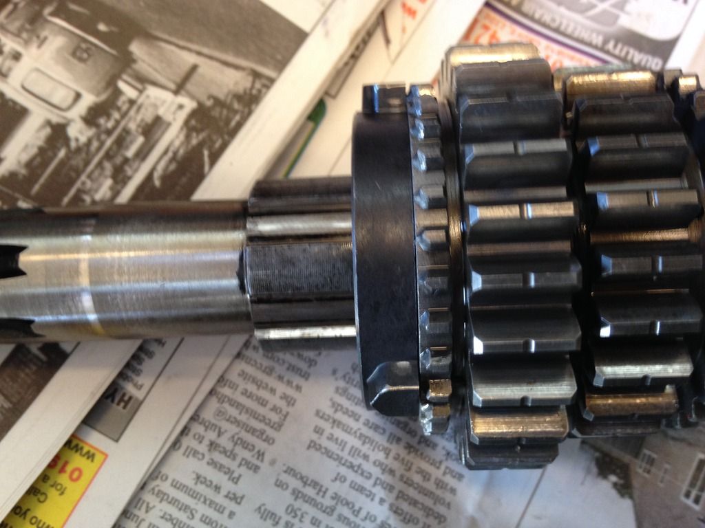

So, a strip down reveals that the baulking on 2nd is shot again, worn to the gear face. Probably gonna want a new 2nd gear now too for good measure. 3rd baulkring is looking worn, but will confim with some other spares tomorrow. 1st and 4th again seem good.

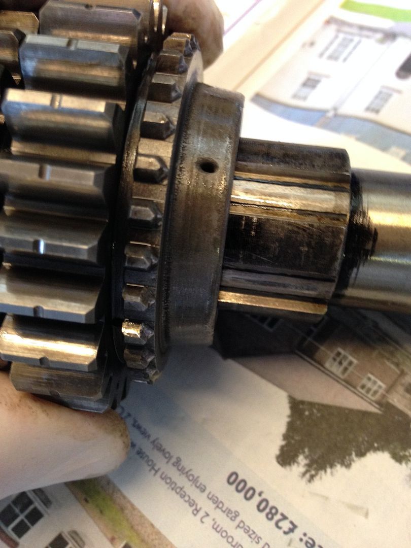

It's not the first time I've seen gear cones like that. Don't know why it happens. I'd send it back to where you bought it. On 13th Jul, 2012 Ben H said:
23rd Mar, 2015 at 11:40:09am
From those photos it seems the cone on the gear itself is clearly the issue, not the baulk ring (unless there is something so bad about the baulk ring material or heat treatment that it has chewed up the cone).

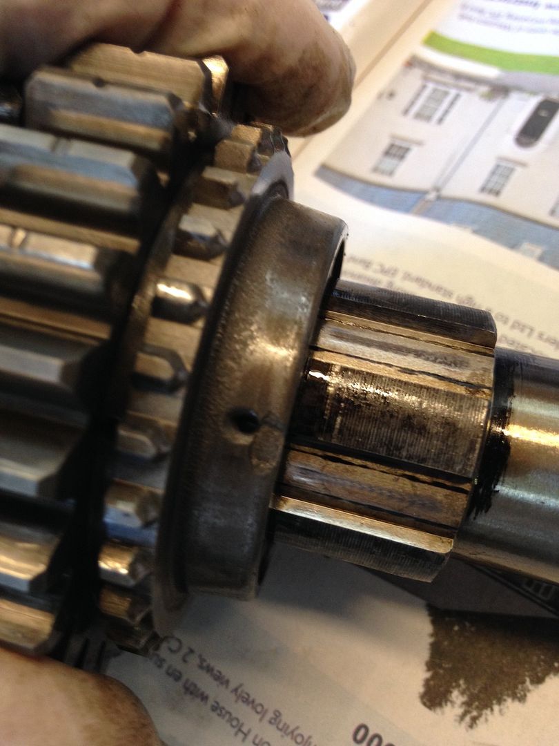

23rd Mar, 2015 at 08:26:32pm
This is the olf second gear from the metro van.

On 24th Mar, 2015 minimole23 said:
Rod, the new baulkring I have lying round has good clearance, trouble is so did the ones that are now looking worn. Andy's one looks even worse. But with that kind of roughness on the cone I doubt a new baulk ring (or even a good used one) will last long before it's clearance has gone. The question is cause/effect - bad material and or heat treatment on the gear cone so it has worn rough and then just wipes out the baulk ring, or a bad batch of baulk rings that destroy an otherwise good cone. If your's and Andy's gears were from the same supplier then it's the more likely culprit. If you have any friends doing a mechanical qualification at a local tech college or uni they would have access to the materials lab which 99% is likely to have a hardness tester - a fairly crude test on the surface of the cone and the inner surface of the baulk ring would give some clues. Schrödinger's cat - so which one am I ??? |
25th Mar, 2015 at 09:31:57am
The gear Andy has shown was an old Minispeed one from an ST ratio gearset.
If something is worth doing, it's worth doing half of. |
