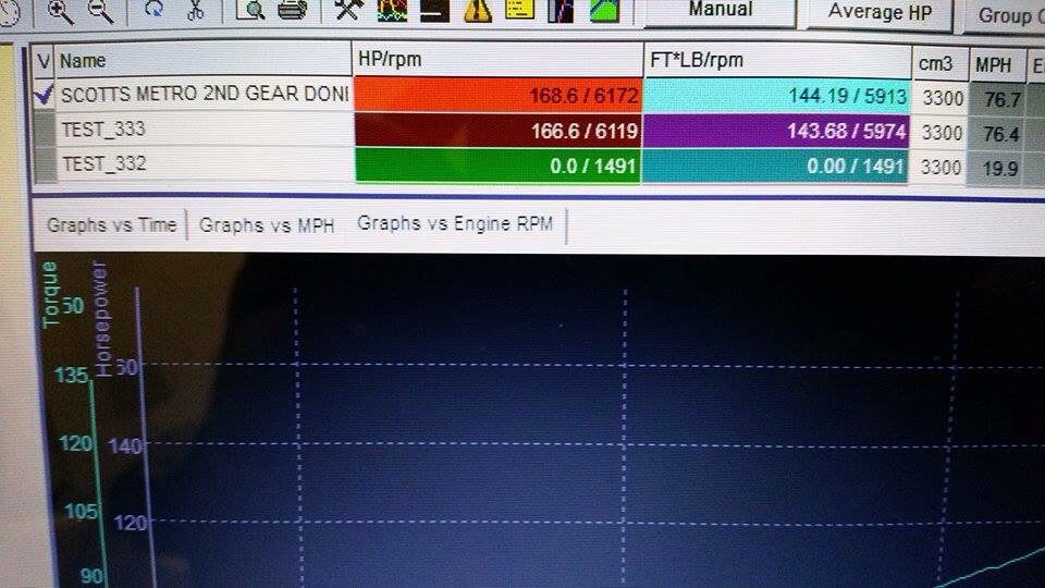

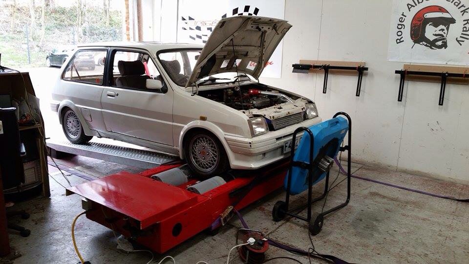

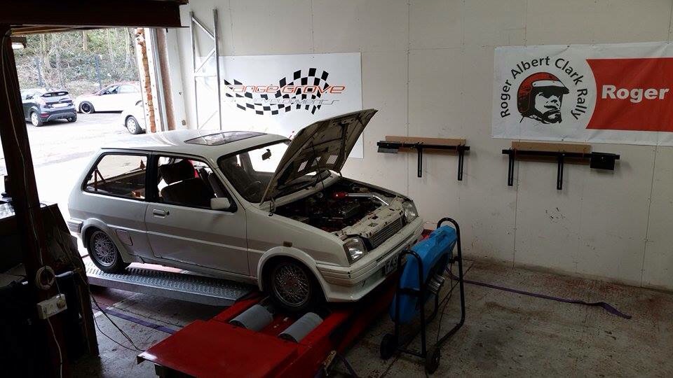

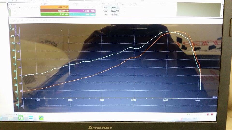

Well been on the rr most the afternoon & setting the car up using the aldon amethyst & results were very acceptable in my opinion 15psi boost t3 turbo still on std turbo Pistons with total seal rings

power figures good scott, top marks, forgot the cam you had in it ?

Nice output! I'd be content with that many bananas. Im sorry but is there a thread/post somewhere on the engine specs?

I've never done a full build thread to be honest but heres the spec
Benross built Sccr box,x pin diff,Central oil pick up pipe,straight cut drops
Std turbo Pistons total seal rings (1275)
Avonbar phase 2 turbo cam duplex timing gears
New oil pump, water pump & shells,centre main strap
Turbo Phil head can't remember full spec but well worked,Titan 1.5 full roller rockers
Ported exhaust manifold & turbo elbow,full 2" maniflow system no centre box
Ultra lite fly wheel pre verto & grey cover
Aldon amethyst ignition
Intercooler & think that's about it compression ratio 8.55-1
