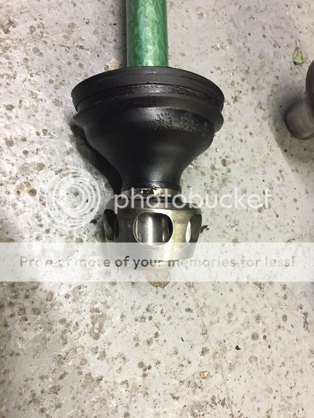

Got a really weird problem. I've just refit my engine... Id covered 1500miles as a turbo with 160lbs previously before having it out.
Now the engine went back together with new driveshaft gaitors the only thing being changed is I mixed up the balls for the point joints.
Less than 1miledown the road and there's a god awful noise/vibration. Turns out the offside drive shaft had been forced out the pot joint just enough for the balls to spin at the end of the pot thus mangling the balls and cage.
Now my car is low and the front has standard suspension.
I fit a new pot joint and off I go for test drive two.... Same thing only this time it's the near side pot that's done it.
I've had the engine out and checked the diff and there's nothing wrong there.
I'm totally stumped.
The old pot joint outers are fairly worn with the ridges/ grooves not as sharp as a new one

You probably have the cage in backwards. Ive done it myself. It will drive until you get to a bump then the balls pop out. Turn the cage around and all is fixed.
What slater says, when my aseries turbo was going to the track for the first time i blew both pot joints pulling up the ramp to the trailer i had previously driven it about but under no great load
As above except I think it's the inner bit of the joint, not the cage. The inner bit can be accidentally reversed and move the balls outwards.
If you look at it closely it's not symettric, the inner bit where tha shaft goes is offset relative to where the balls go.

I'm sure the inner race in on the right way round (mainly because I didn't take that part off) and because of the groove the gaitor sits on.
I see what you mean about the cage... Can the cage be taken on and off with the outer cv attached? As it can only go one way. Unless you have to put the outer cage on before the race...

That cage looks the wrong way to me

I think the cage can come off if you take the boot off and slide it down the shaft.
Its definitely the wrong way round.
The cage is deffo on the wrong way, and I'm sure of you just rotate the cage a little it should just roll off

yep, the centre cant go the wrong way around iirc
once the balls are out the cage should wriggle off , and is 200% the wrong way
My bad, it's the cage wrong, not the inner part like I thought....
My only excuse is it's been two years since I tried to put one together wrong...
Also, remember that there are two sizes of Pots.
I remember this very issue when i couldn't get the drive shafts to mate up with the pots on a replacement engine. I think in this case, the pots are the same as previous so should be no issue?

This is one if my mini related bug bears, on other joints on other cars you wouldn't dream of randomly mixing and matching inners outers cages etc, yet for most it's standard practise!
What you can do to keep the joints in one piece is knock the pot joint inner spider off the driveshaft. It is on a spline and internal o clip. That way you don't have to disturb the gaiter and get shitty grease everywhere, and can leave the entire joint in the diff.
