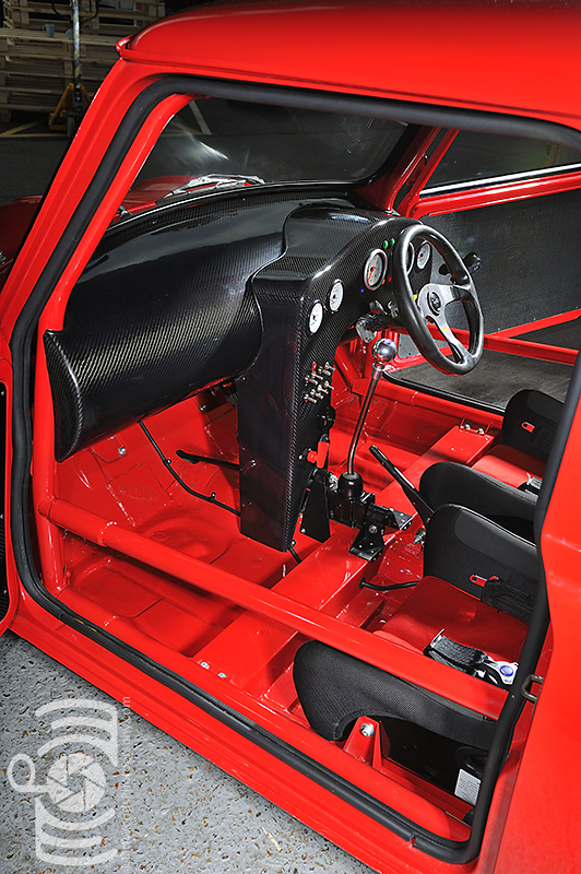

Thanks for the info and pics guys. Looks like i will be buying a new seat sooner rather than later so we can align all this shit up
i attacked it the other way on, my carbon seats are rather wide and have to be fitted in slightly staggered they went where they had to, i then moved the wheel, gear stick and handbrake *happy*
t3gav
2395 Posts
Member #: 229
Gavin@minispares.com
kent
Yeah mine are staggered, mainly cos I'm a short ass but it helps with clearance around the headrest area and B pillar.
