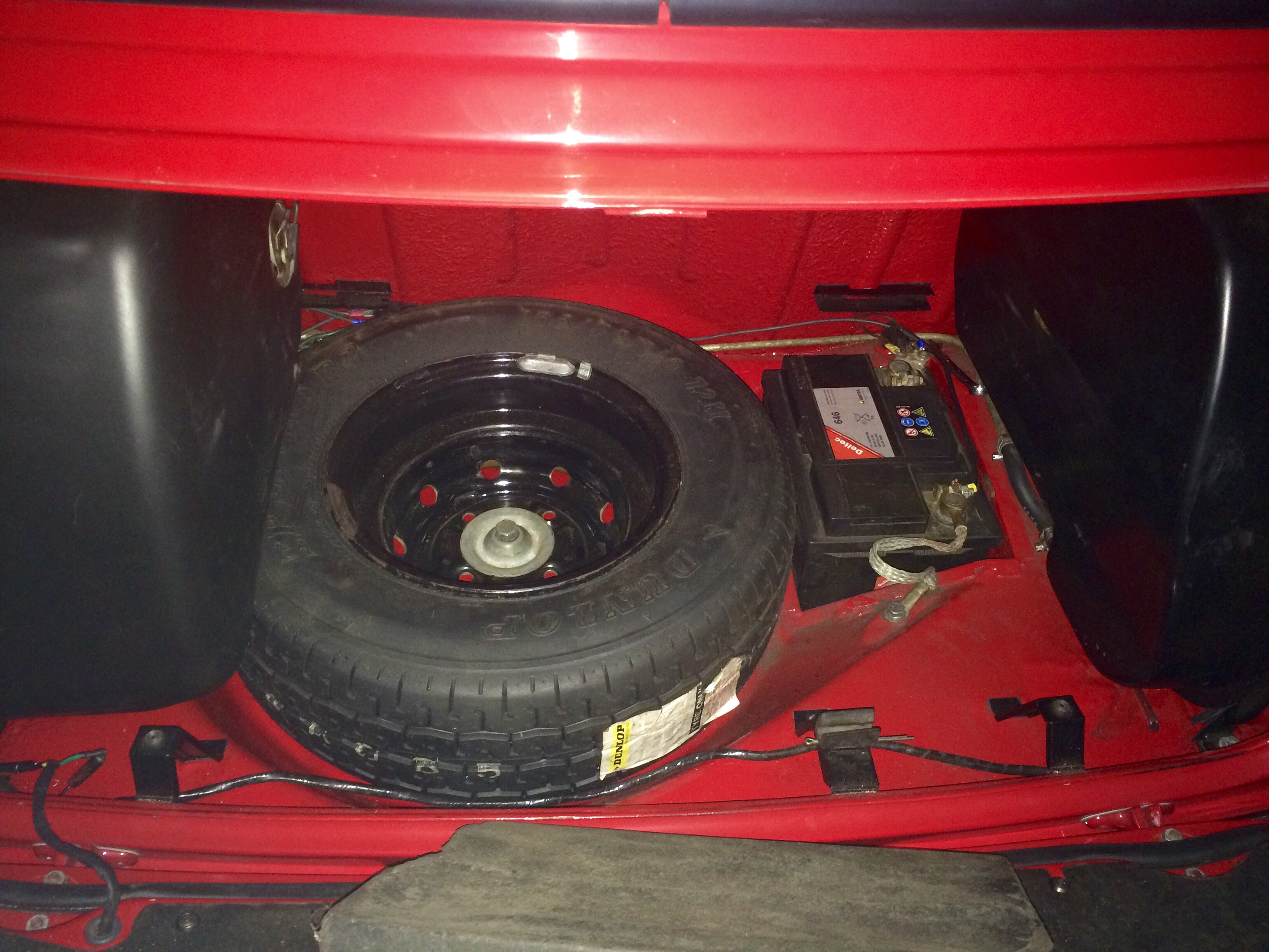

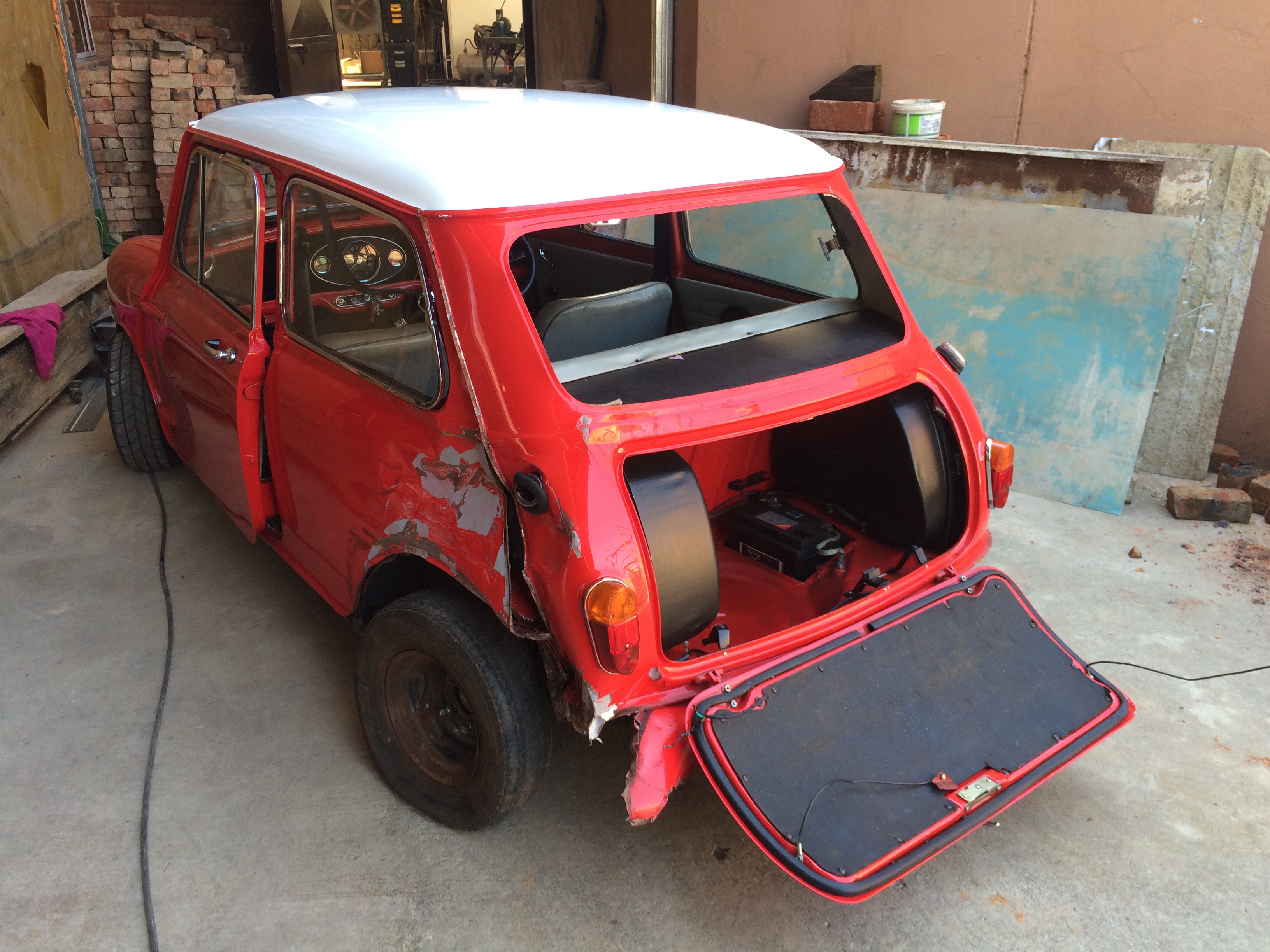

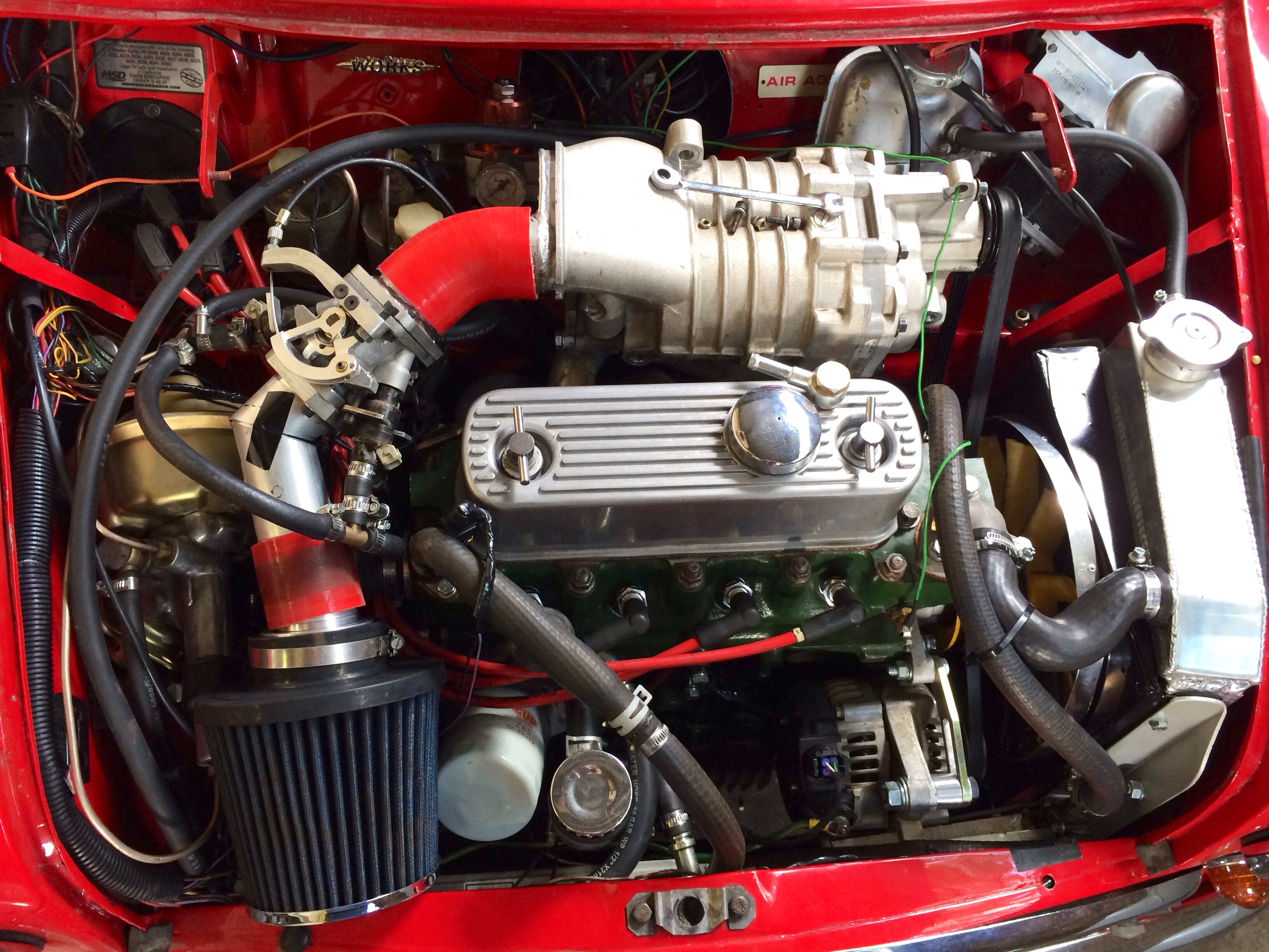

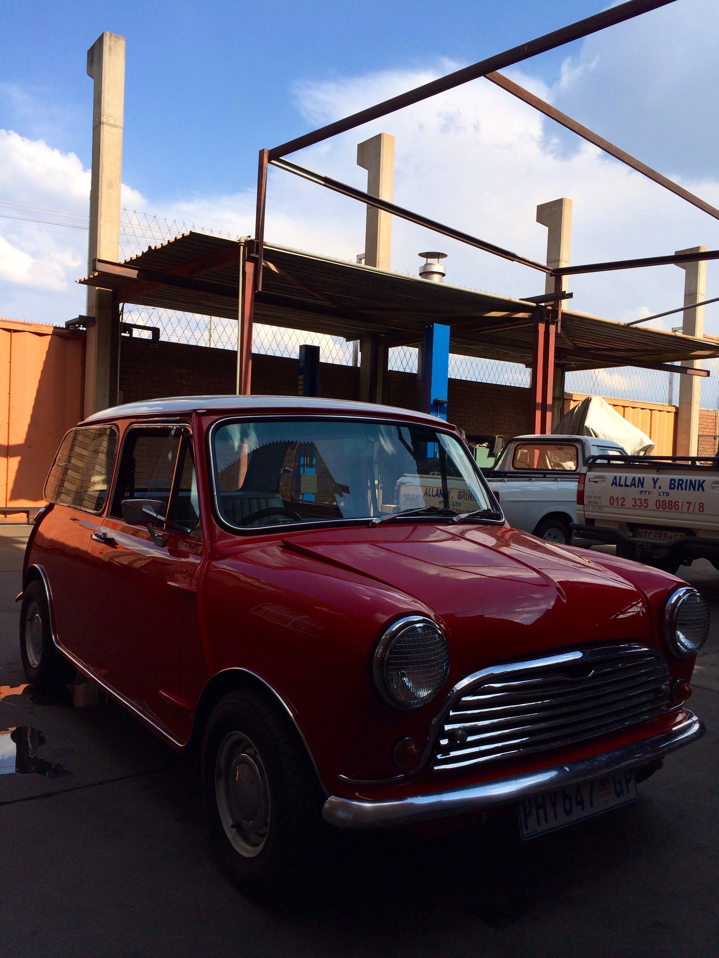

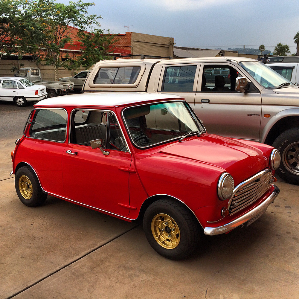

Hello all,
Last year with the help of friends, I managed to build my version of a fast road car.
Unfortunately she's been totaled so I want to ask for some creative advise for when I rebuild Road car 2.0 later so here's some photos.
Spec is or was;
1966 Morris Cooper S
Stock Rod shift gearbox with centre oil pick up
SA block bored out 73mm
1275cc Crank stroked to 86mm
S connection Rods
Eaton M45 Supercharger home made manifold and pulleys
276 Cam
Cooper S brakes with servo on a vacuum pump
ATS 5j 10inch rims when S rims were off
South African S interior

Best of luck with the rebuild. Look for my rebuild thread 'The Rebirth' in here. I had a big accident in it and am fixing it now

Nice car, shame about the crash. Got any pictures of it with the ats classics fitted? I have some but unsure whether to use them or not

The ATS's are genuine, one of the reasons I bought the car as I haven't seen another set in SA before
