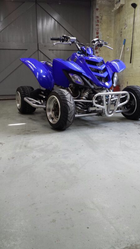

mw3
684 Posts
Member #: 9590
Derby
All together now, just need a few things to get ready for MOT!
