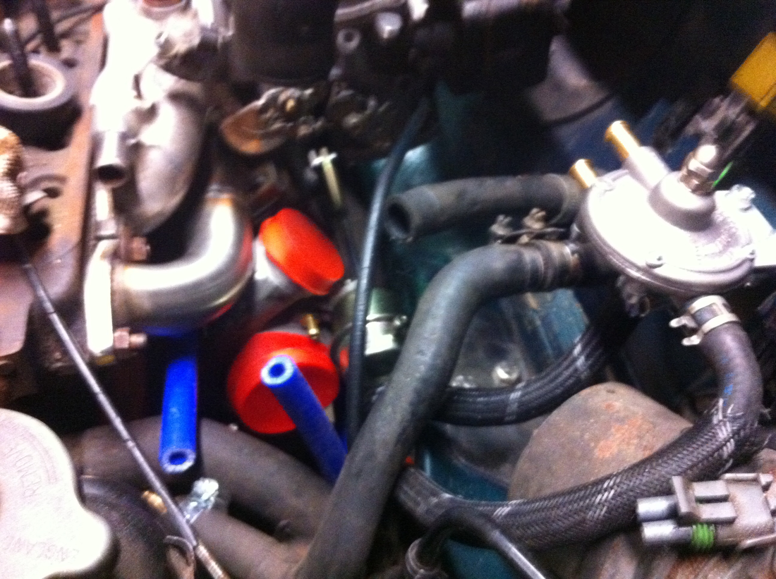

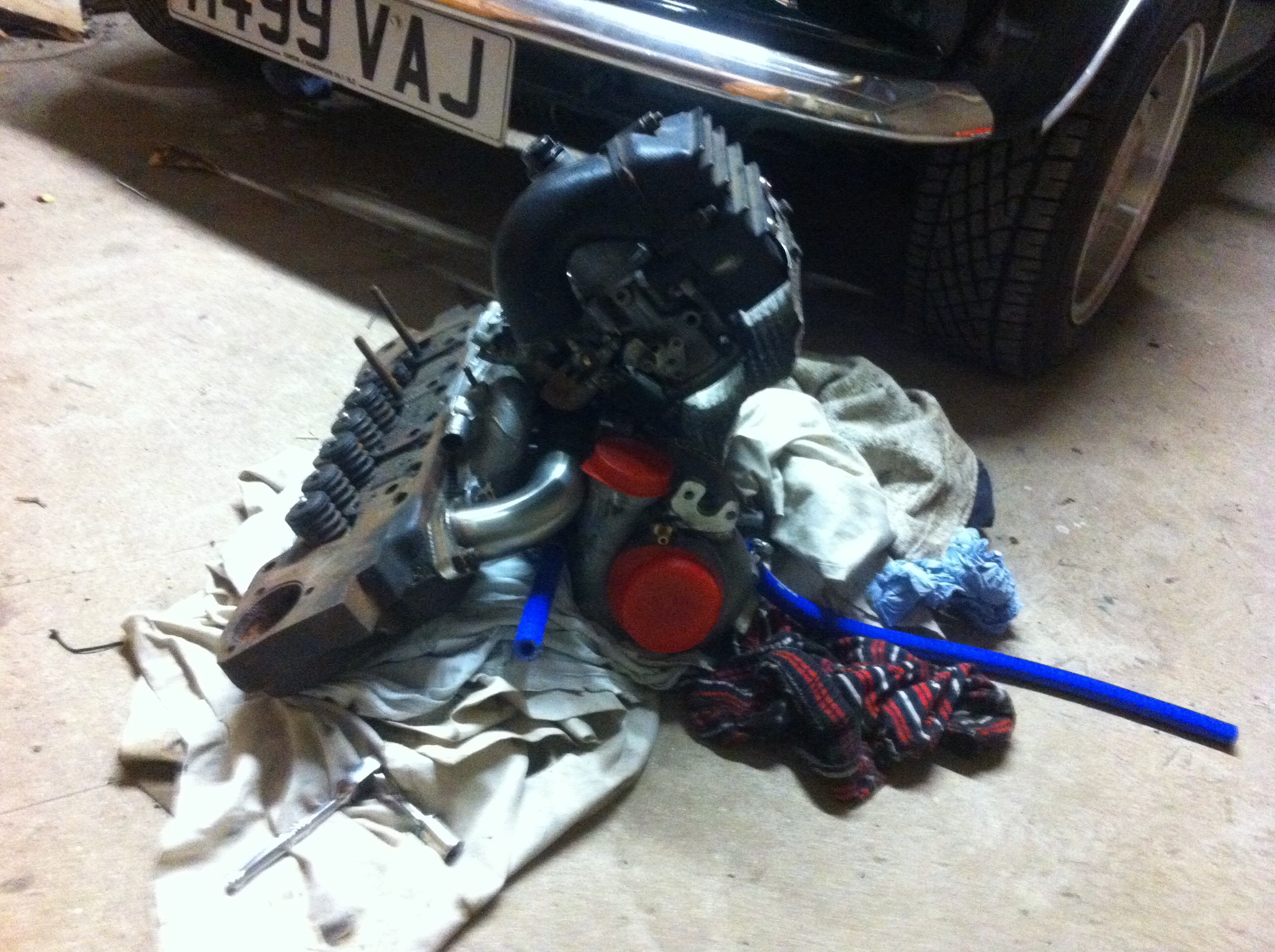

fixitphil2
116 Posts
Member #: 10945
scarborough/ northyorkshire
get some spi coolant pipes, they have the t off built into them that went too and from inlet manifold,i got the saab metal water pipe from ebay and cut what length was needed, the bajo bolts are 14x1.5 and the oil feed is 12x1.25 .not the best pictures but all iv got

fixitphil2
116 Posts
Member #: 10945
the blue pipe that runs just under manifold go,s to the top radiator hose with the take off for spi inlet manifold and the other lower one go,s to the bottom radiator hose that has the return pipe built in
fixitphil2
116 Posts
Member #: 10945
no need to drill block just use some spi hoses
JT
2742 Posts
Member #: 637
Hertfordshire
I'm not sure how you've plumbed in your return to the top hose?
Have you cut a bottom hose up?
I've been thinking as well. I can't use water pump bypass take off for the turbo feed as it pumps water the wrong way!! lol
