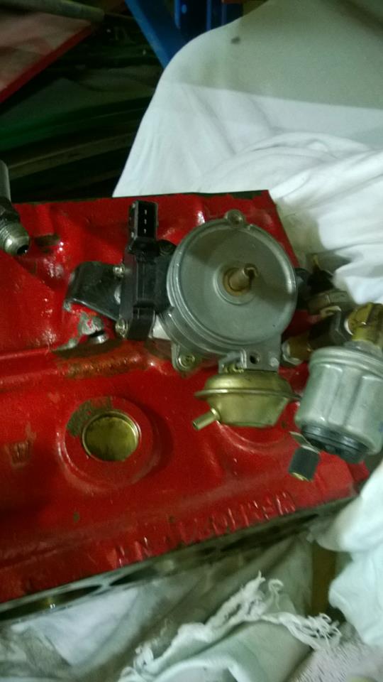

Hi can anyone help this guy ?
He owns a ERA, and the pistons has cracked around the rings.
he told me the head is only 69mm tall, which means its been skimmed.
But i would like to know, if the distributer is correct ?
he says there are no numbers on it ? (anywhere ?)
Its not the same type as I have (mine only has 2 wires)
how can I be sure its a genuine turbo distributer ?
I've seen the three-wire modules before; think they were used on the Maestro's and some random ford model perhaps?
Regardless,
The external of the dizzy is like taking for granted a paint colour is the same as what the lid says... He needs to separate the housings, then note the markings on the weights and on the springs, and compare to the known specs (or a known example)...
The Vac can should also have some markings.

Thanks, I will foreward your answer to him.
Do any of you know which kind of markings he should look for ?
My distributer is not the same, the wires from the Black box are part of it, and there are only 2.
Not sure if the internals will match ?
