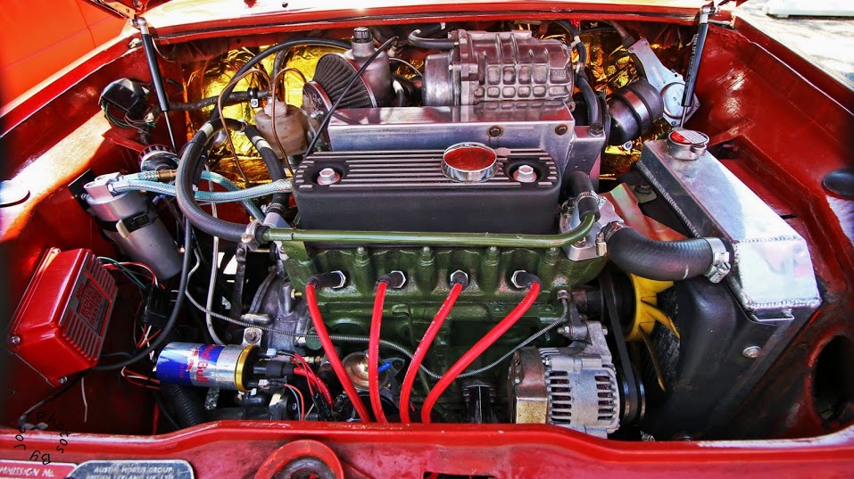

So I installed my Sc12 Supercharger a little over a month ago. Was making about 6psi for a happy 500 miles or so. Booked it in for a dyno tune session and blew the head gasket on the way home... or so I thought. I was climbing a hill on the highway for about 10 seconds under boost and suddenly I lost power, and I had heavy white smoke come out of the tappet cover breather.... the smoke eventually dissipated, but the car felt off. I did a compression test when I got home and it showed #4=70 #3=90 #2=140 #1=135
So I pulled the head, and did not see what I was hoping for, blown between 3 and 4. I did not loose any coolant, overall car ran close to normal temps. It looked more as if the head had lifted. Anyway, fast forward to last week, fitted a new copper head gasket, ARP studs, torqued it down, then warmed up, retorqued and took it for a test run before rallye next day.
Everything was running fantastic, best it ever had. 30 minutes into run climbing a hill doing about 65mph... lost power, white smoke out the tappet cover breather... real heavy smoke. Sounded like it was running on 3 cylinders. Now CLUTCH is slipping, I only assume to possibly oil making it's way past the seal? I don't understand why I am getting so much crank pressure. Half my engine bay is covered in oil now, and left a huge oil spot under the car.
Engine is 1098 (STOCK), was in good health before charger, probably not so much anymore. I figured 2 breathers (1 on rocker cover, and 1 modded on the rear tappet cover), would have been sufficient. These are dropped into a vented catch can. Filter on catch can is soaked in oil, it actually puddled on the filter.
Anyway, at this point I am about to fit a stock carb back on the engine in hopes I can still cruise this summer/fall. I am building the garage and not gonna have time to fuss with it to much. I have a feeling clutch will probably not "burn" the oil off. As long as I wasn't laying into boost it would hold and not slip...
Thoughts?

if you have s sudden increase in blowby you can pretty safely speculate you have cracked a ringland or 3 or burnt a piston up. sorry bud.
oddly, when I used to work on tuned motors day in day out, people would always say a motor was "running the best it ever has" right before it went pop. I speculate that the lean mixture or overly advanced ignition makes the engine a little more perky.
Denis O'Brien.
My thought is that you've knackered your ringlands. Going NA now will still end up with oil oozing everywhere.
My other thought is that if the pistons are the circlip type then the circlips may have failed. Although this causes obvious damage to the bores.
Arnt the 1098 pistons pretty weak too?
Thoughts?
So you had a test that showed low compression, removed the head and say the HG was sealing ok.....then you put it all back together again ?
When it was apparent the low test was not down to head gasket, then you needed to pull the engine and inspect the pistons. As it sounds like they've broken.
Presumably you didnt do a compression test after fitting the new head gasket to see if anything changed ?
Either way, engine needs to come apart, and once it's all back together it needs tuned by a competent person.

Honestly, I had never encountered this problem before. I was expecting a blown headgasket, or hoping for that. The gasket was wet around the outside edge of block. Checked head for warping, it was fine. Number 4 bore looked to have had a little bit of wear on 1 side, but not much else to report. The tune I thought was fine, no detonation, no pinging, plugs looked perfect, temps were 195 consistently. Anyway, that's where I am at right now. I'm not gonna have space to pull the engine and work on it next few months, that's why I was trying to get it ready before summer/fall season and just take it easy. Might just have to drive the Trabant around this summer.

Unfortunately you cannot assume pistons are ok by looking at them whilst still in the bores.
All symptoms you describe sound like broken pistons.

blow by like that can only come from a burnt piston or broken rings imo
because you say no coolant lost and that there was no visible sings of cylinder to cylinder blow by say to me head gasket is unlikely.. so imo its rings or piston damage you have suffered
might be wrong and im no expert mind !!
im assuming you have good crank case breathers
